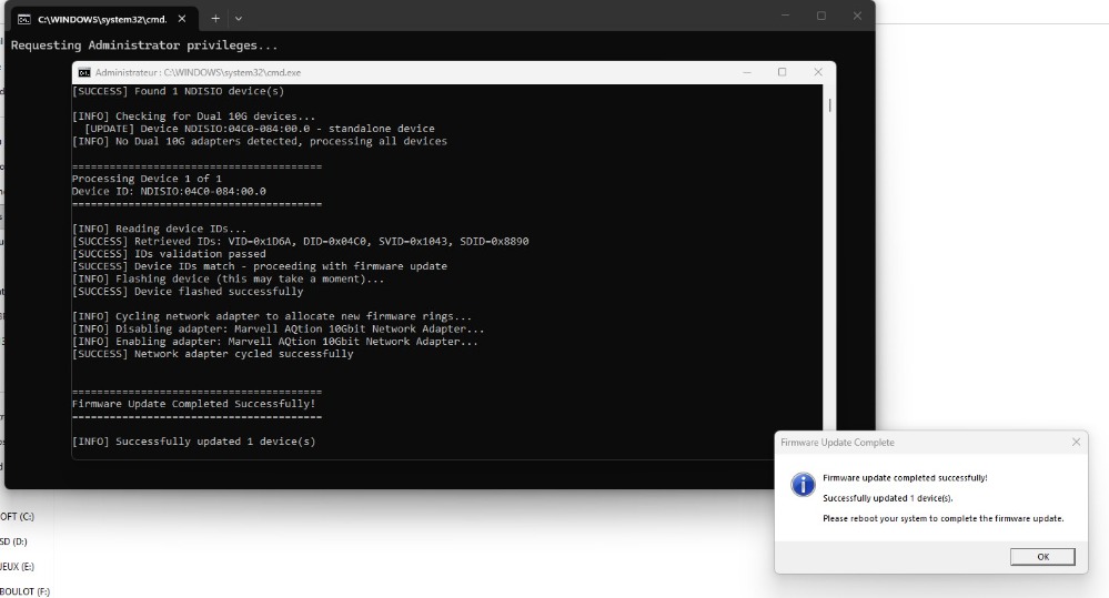

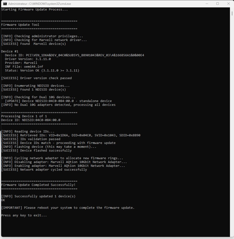

Updated PCIe Asus XG-C100C V3 successfully. Just had to change SDID=0x8890 to SDID=0x889A at 2 places in the PS1 script. Ignore the places that have # comment though.

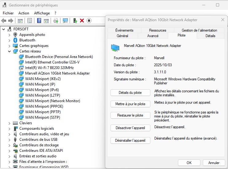

Apart from mismatch of Device IDs, the updater also complains if you don't have the latest 3.1.11 Marvell driver. It's there in driver section btw.
