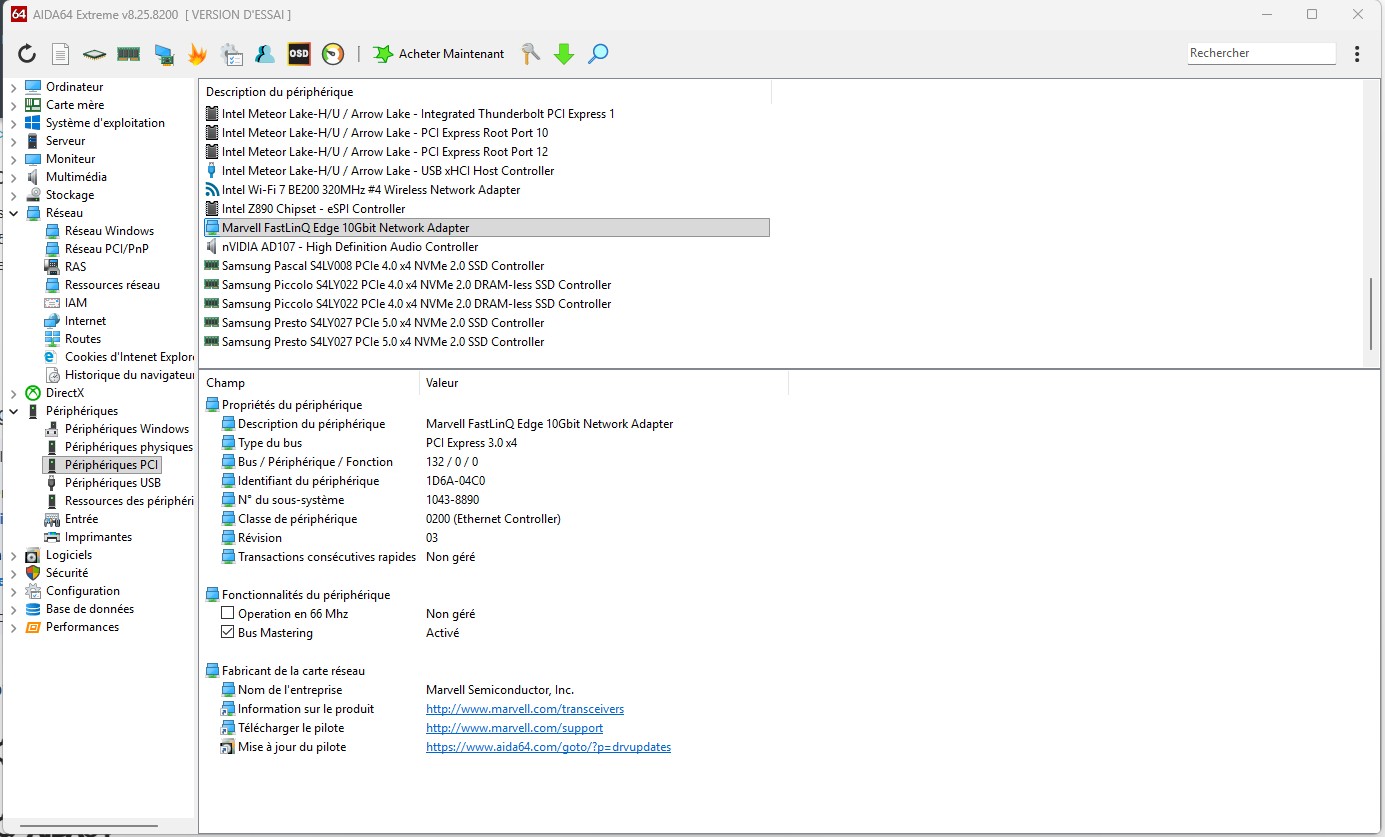

Re: Marvell/Aquantia AQC113, AQC113C, AQC-113CS (10Gbps) Firmware Version 1.5.45
il y a 6 mois 2 semaines
I try to post in english but if it's not clear, i'll try in french
I need to be sure than this firmware is good for my device. Because old fw posted before have bricked my device.
Can you confirm with this screenshoot that it's ok for me. And in this case, can you explain wich line on the script fine need to be modified to flash ?

Re: Marvell/Aquantia AQC113CS (10Gbps) Firmware Version 1.5.45
il y a 6 mois 2 semainesSame error on my Asus X870E Motherboard with AQC113CS
I guess this firmware is only for PCI-E cards.
