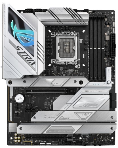

Information______________
  • Format: ATX
  • Nom de code: Raptor Lake
  • Socket: 1700
  • Memoires: DDR5
  • Cpus: Intel Core I3/5/7/9 (12e & 13e Gen)
  • Audio (1): Realtek HDA ALC4080
  • USB 3.x (1): Intel Z790 USB 3.2
  • Reseau (2):
  • Wireless: Intel AX7xxx Wifi 7
  • Bluetooth: Intel AX7xxx Wifi 7
  • Lien officiel: https://rog.asus.com/
