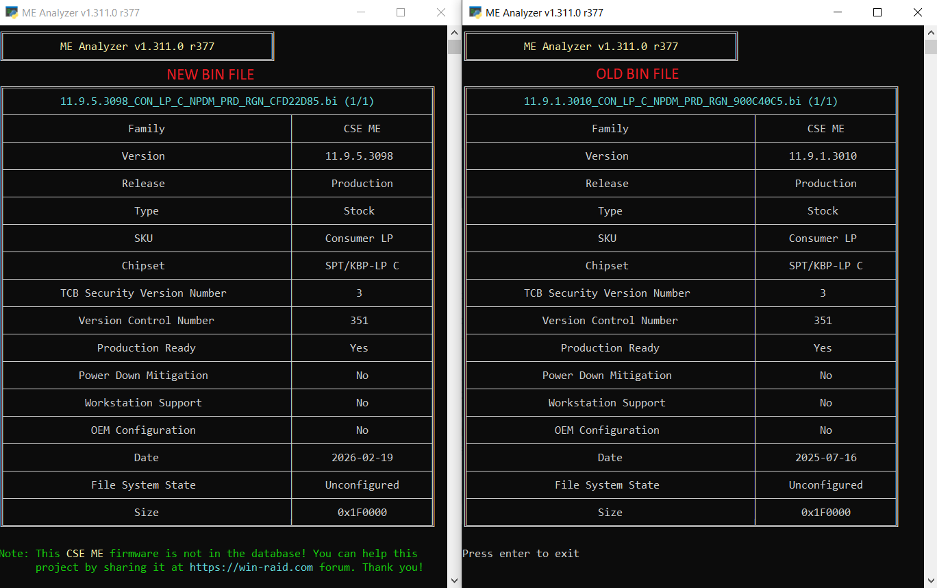

Latest MEAnalyzer (MEA v1.311.0 r377)
winraid.level1techs.com Original post
winraid.level1techs.com 11.9.5.3098_CON_LP_C_NPDM_PRD_RGN_CFD22D85.rar
winraid.level1techs.com MEA.dat
station-drivers.com Intel Management Engine (ME/AMT) Firmware Version 11.9.5.3098 (LP)(1.5Mo)
Date & Version: 2026/02/19, 11.9.5.3098 (1.5Mo)
Release: Production
SKU: Consumer LP 1.5Mo
Region: Stock
Chipset: SPT/KBP-LP C
For: Intel 100/200/300-series LP chipsets
Includes: Firmware 1.5 & Utilities

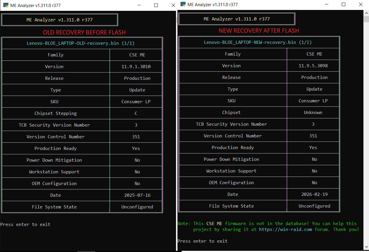

Firmware Backup Instructions
1. Open Command Prompt / Terminal as Administrator and navigate to the folder containing FWUpdLcl64.exe.
2. Save the current firmware by running:
3. This will save a backup of the current firmware as recovery.bin.FWUpdLcl64 -save recovery.bin
Firmware Update Instructions
1.Make sure the new firmware file is in the same folder as FWUpdLcl64.exe.
2. Again, open Command Prompt / Terminal as Administrator in that folder and run:
3. This will flash the new firmware to the device. Do not interrupt the process or power off the system while the firmware is being updated.FWUpdLcl64 -F 11.9.5.3098_CON_LP_C_NPDM_PRD_RGN_CFD22D85.bin
4. Reboot
Important: Make sure you have a valid backup (recovery.bin) before proceeding with the firmware flash.

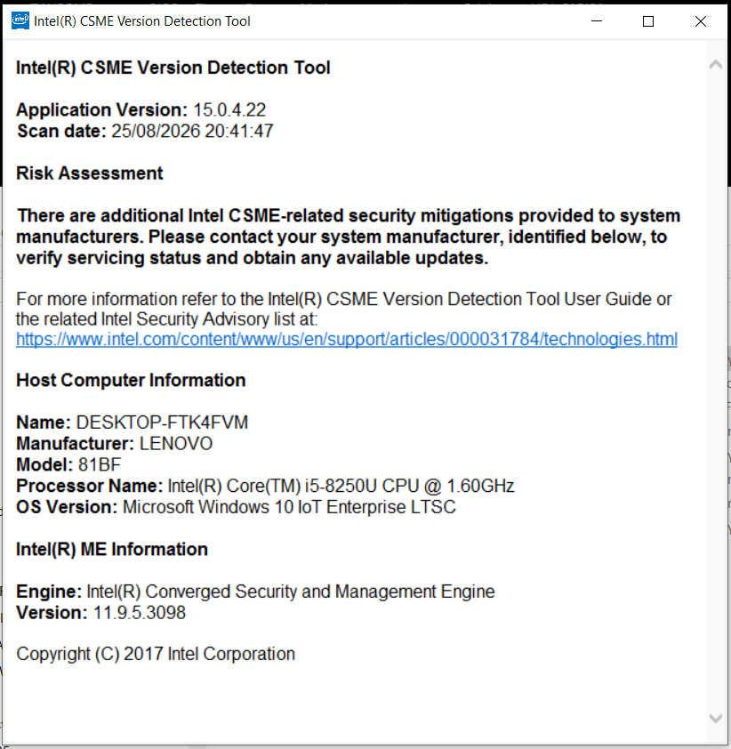

🔐 CSME Firmware Update
The 11.9.5.3098 firmware is a security update that fixes INTEL-SA-01371, INTEL-SA-01372, and several previous vulnerabilities.
However, the new CSMEVDT 15.04.22 still reports that there are additional CSME security mitigations provided to system manufacturers.
This is expected with an older laptop:
🔵 Intel releases new CSME security fixes
🏭 The OEM adapts and tests the firmware for the specific laptop
💻 11.9.5.3098 is now installed ✅
🛡️ CSMEVDT 15.04.22 detects additional OEM mitigations
⏳ Waiting for a newer OEM firmware release
So, the 11.9.5.3098 update was successful and fixes the vulnerabilities listed in its release notes.
The CSMEVDT message simply means that additional mitigations may still require a newer firmware release from the laptop manufacturer.
