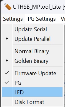

Boitier Sabrent
Warning!! On the Sabret case shown above, as with others, you will lose the RGB animation of the case (if it exists); only the activity light will work.
Before flashing, you unchecked LED in the menu?
  • Absent
  • Messages : 702
  • Thanks: 478
il y a 6 mois 6 jours
Yes, but unfortunately that also erases the LED firmware.
