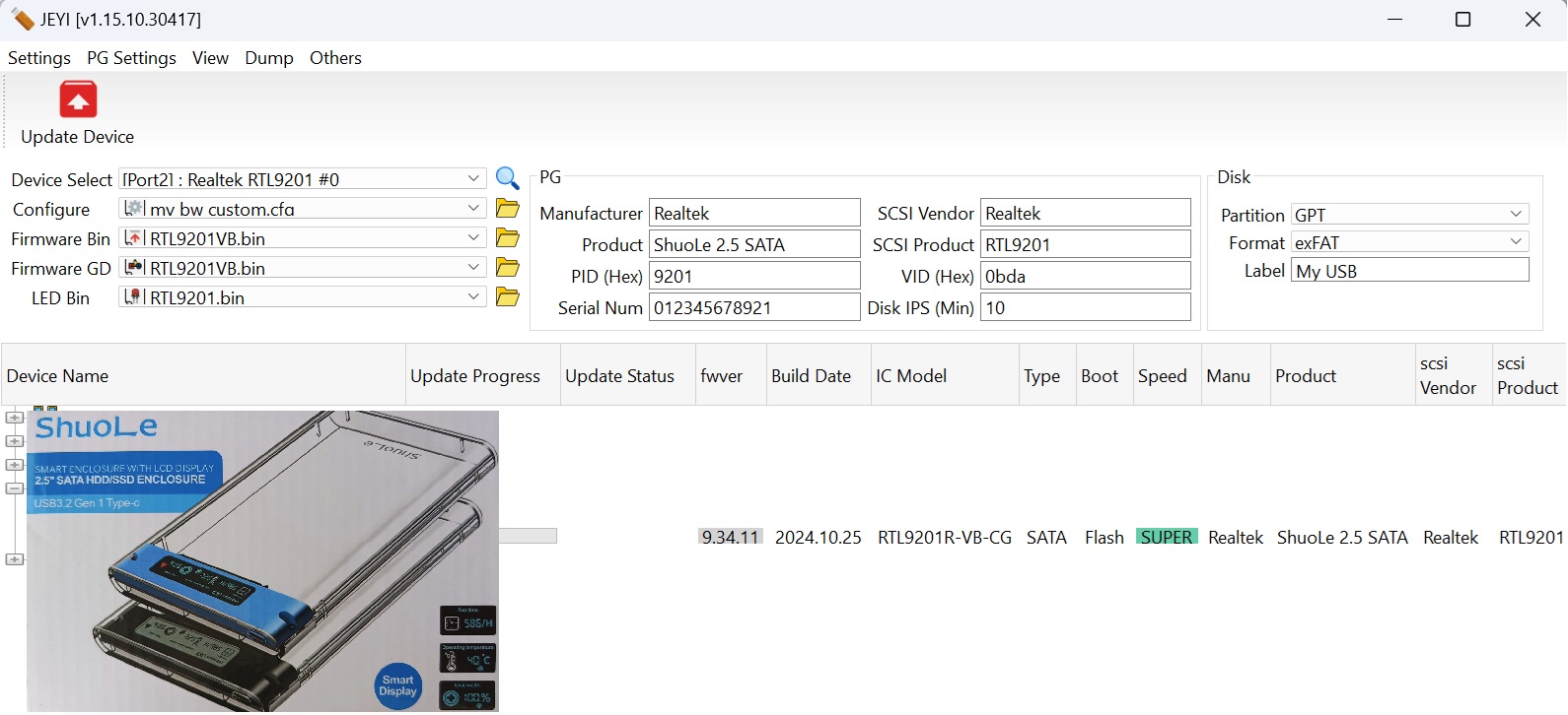

4 hours 29 minutes agoDid you flash it to 9201R? it wont select Firmware Bin for me with a 9201R plugged inExcellent firmware. PERIPH_API for LCD is now supported. I successfully flashed the ShuoLe enclosure with BW LCD.

4 hours 15 minutes agoYes.Did you flash it to 9201R? it wont select Firmware Bin for me with a 9201R plugged in

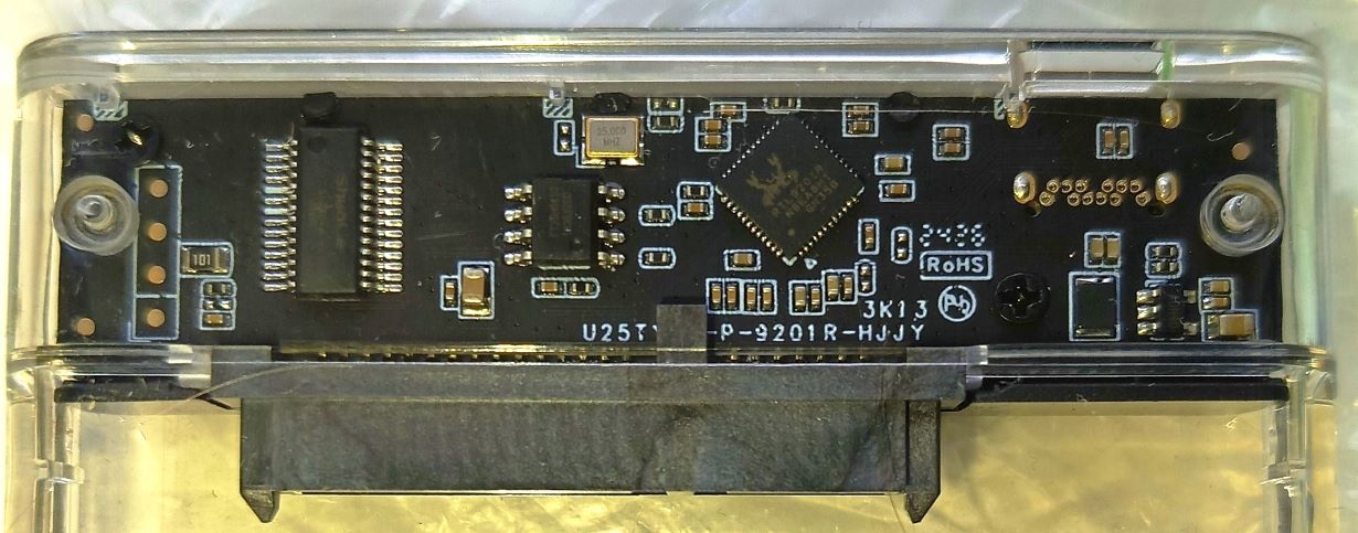

I think i know what the problem is some of my RTL9201R's have 2Mbit spi chips
this firmware is 452k so it needs 4Mbit though there's alot of FF's in the file so i may be able
to trim it down
Ok it can only trim down to 244 KB it wont flash to a 2Mbit SPI
I know a few of my pcb's have 8Mbit SPI's some 4Mbit some 2Mbit
I have checked my enclosures
Cofre Disco Duro x 5 4Mbit SPI 1.33.88 Firmware Flashable 4Mbit SPI (needs correct LCD.bin will test flashing one at some point)
UTHAI/ShuoLe U25N-L x 2 4Mbit SPI 1.34.29 Firmware Flashable 4Mbit SPI (needs correct LCD.bin)
UTHAI Q5 x 4 2Mbit SPI 1.32.7 Firmware
UTHAI Q6 x 6 2Mbit SPI 1.32.7 Firmware
UTHAI Q7 x 7 2Mbit SPI 1.32.7 Firmware
to trim it down

I have just noticed i can extract the led.bin from spi dumps
its 0000 to 3FF0 its the first thing flashed to the SPI
I will do the Cofre Disco Duro and UTHAI/ShuoLe u25N-L led.bin's in a few mins
