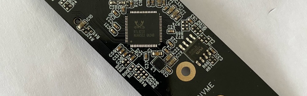

after updating to the latest firmware all ssd are not writeable, any idea how to fix this ?
I used the attached .cfg files...when flashing to higher firmware....
Chipset pic attached, seems to be:
RTL9210 N6AK5E2 GN24B
Nick

- Posts: 45
2 years 11 months ago - 2 years 11 months ago
write protection switch present 0xa, 0xc
SCSI_WP_PIN = 0x0
SD_MMC_TYPE = 0x0
SCSI_WP_PIN = 0x0
SD_MMC_TYPE = 0x0
