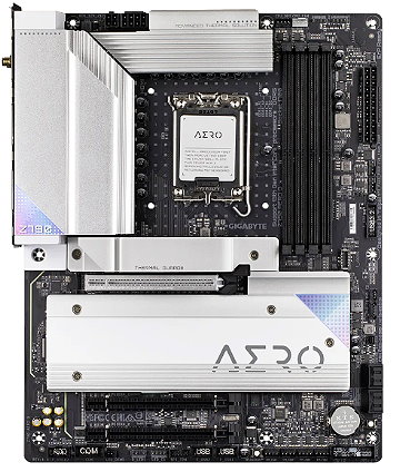

Information______________
  • Format: ATX
  • Nom de code: Raptor Lake
  • Socket: 1700
  • Memoires: DDR4
  • Cpus: Intel Core I3/5/7/9 (12e & 13e Gen)
  • USB 3.x (1): Intel Z790 USB 3.2
  • Reseau (1): Marvell AQC-113C (10Gb)
  • Wireless/Bluetooth: Intel Killer Wi-Fi 6E AX1690
