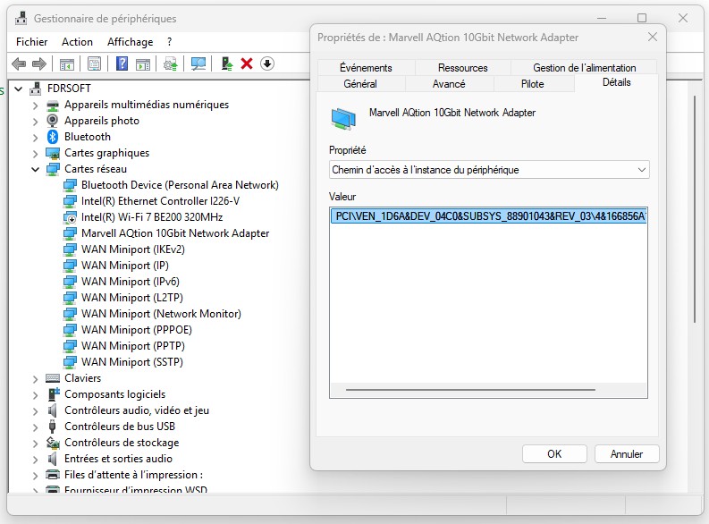

Okay, in Windows Control Panel, can you retrieve the Marvell ID?
  • d5aqoep
  • d5aqoep的头åƒ�
  • poster 4
  • poster 4
  • 帖子: 15
  • Thanks: 2
Re: Marvell/Aquantia AQC113CS (10Gbps) Firmware Version 1.5.45
2 �时 54 分钟 �
Yes I can get all the IDs there.

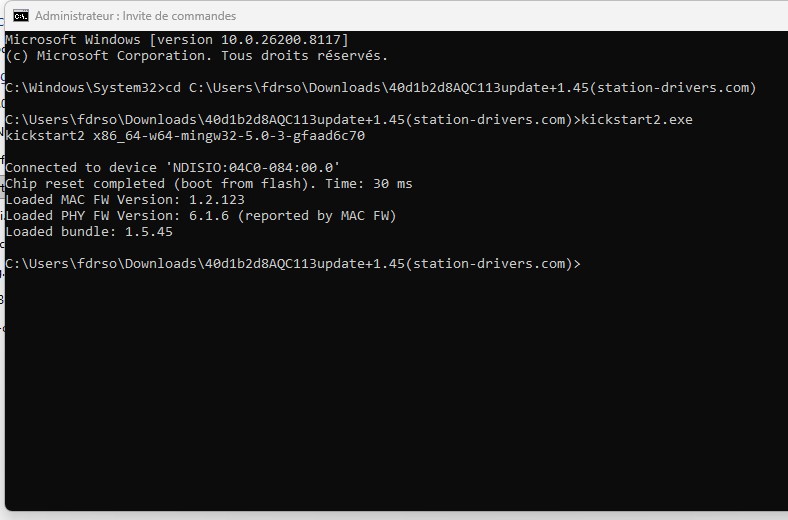

Try the command kickstart2.exe to get information about the board and see what's missing.
