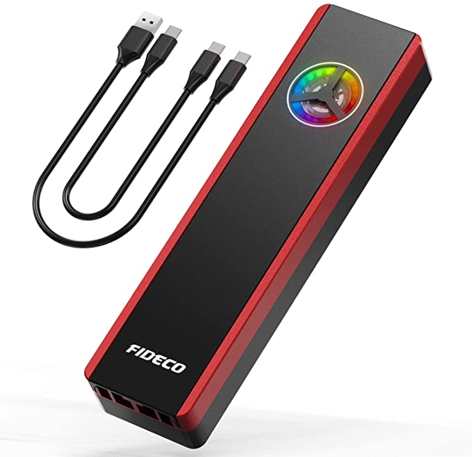

- oliver972
- Inlägg: 1
3 år 2 månader sedan
Admin,
I have 5 of these Fideco M209CPS adapters and was wondering which Firmware version would be the best for updating them?
I attached Pics of the adapter and a Config file from one of them. They are beautiful devices with built in fans.
Thank you, Larry
Thank you, Larry
Författare till inlägg
- Inlägg: 654
- Thanks: 401
Hi, the best would be to already save everyone's configuration then put the latest firmware by modifying the configuration file before the update to adapt it to the new firmware
If needed, there's sdefrwggerg who knows more than me
