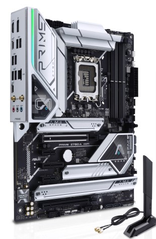

📄Information______________
  • Format: ATX
  • Nom de code: Raptor Lake
  • Socket: 1700
  • Memoires: DDR4
  • Cpus: Intel Core I3/5/7/9 (12e & 13e Gen)
  • USB 3.x (1): Intel Z790 USB 3.2
  • Reseau (1): Intel I225V (2.5Gb)
  • Reseau (2):
  • Wireless: Intel AX211 Wifi 6
  • Bluetooth: Intel AX211
  • Lien officiel: https://rog.asus.com/
