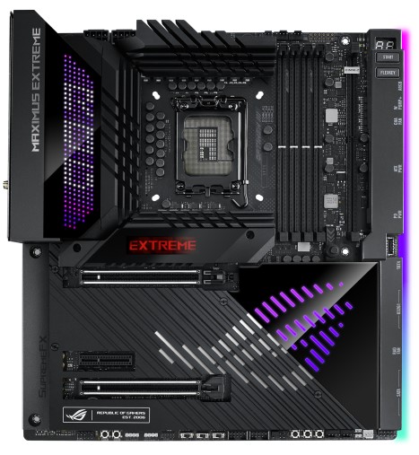

Information______________
  • Format: ATX
  • Nom de code: Raptor Lake
  • Socket: 1700
  • Memoires: DDR5
  • Cpus: Intel Core I3/5/7/9 (12e & 13e Gen)
  • Audio (1): Realtek HDA ALC4082
  • USB 3.x (1): Intel Z790 USB 3.2 Gen2
  • Reseau (1): Marvell AQC-113 (10Gb)
  • Reseau (2): Intel I226-V (2.5Gb)
  • Thunderbolt: Intel
  • Wireless: Intel AX210 Wifi AX
  • Bluetooth: Intel AX210 Wifi AX
  • Lien officiel:
