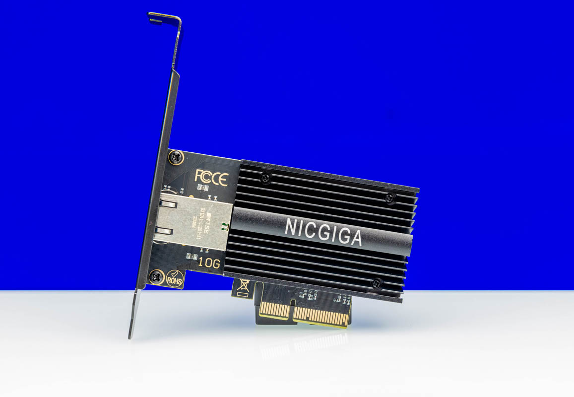

I picked up a newer revision
WOL works on it Its AQC113 and not AQC113C
Its PCIE 4.0 x 4 not 3.0 x2
Firmware is 1.5.38 out of the box
Connected to device '0000-0B:00.0'
Chip reset completed (boot from flash). Time: 70 ms
Loaded MAC FW Version: 1.2.122
Loaded bundle: 1.5.38
NICGIGA REV2.0 GiGaPlus Rev 2.0
FourPartIDs:0x1D6A:0x04C0:0x1D6A:0x0001
Fenvi / NICGIGA REV1 GiGaPlus Rev 1
FourPartIDs:0x1D6A:0x14C0:0x1D6A:0x0001
REV2.0 PCIE 4.0 X4 Firmware 1.5.38 WOL AQC113
REV 1.0 PCIE 3.0 x2 Firmware 1.3.21 NO WOL AQC113C
REV 1.0 AQC113C
REV 2.0 AQC113
REV 1.0 AQC113C
REV 2.0 AQC113
