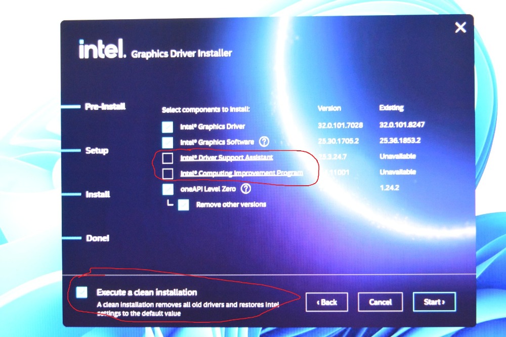

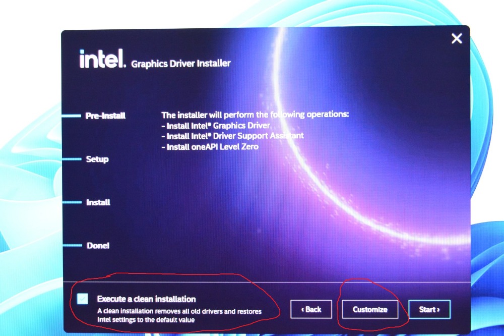

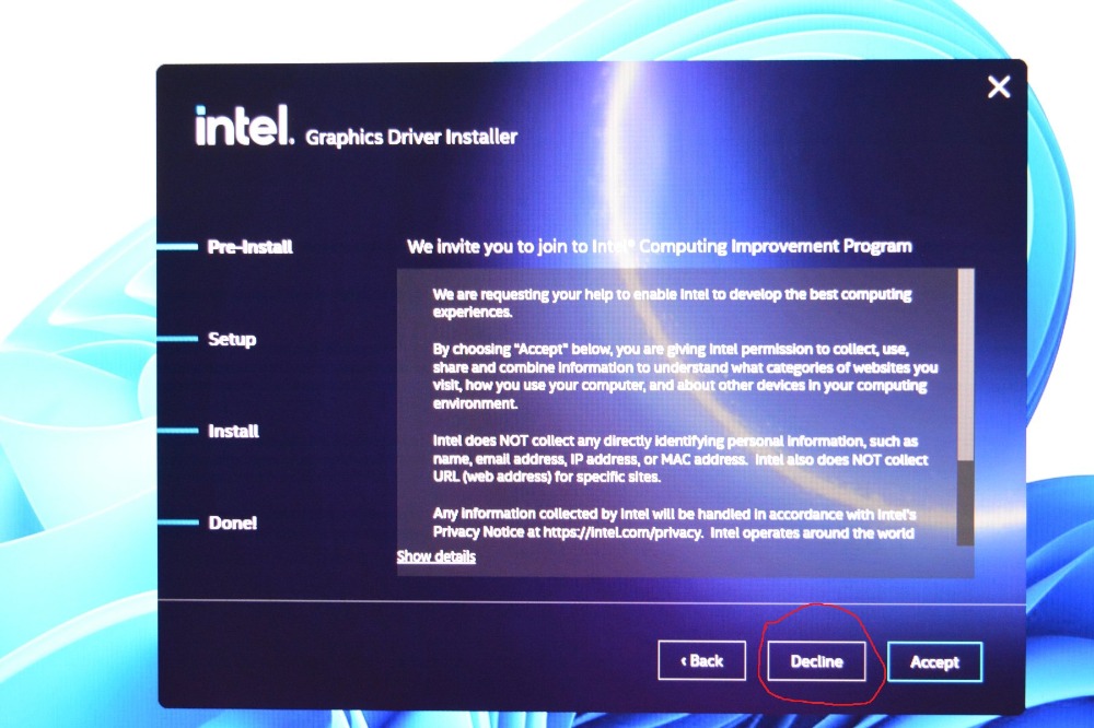

I thought I would share a problem that I was having with my ASROCK B580 Challenger card that was causing a lot of BSOD's or Blue Screens of Death.
I went onto the Intel forums and the Moderators told me that there is a problem with the Intel software called Intel® Computing Improvement Program it can cause your your PC to BSOD at random which happened to me 4 to 8 times a month until the Mod's at the Intel Forum told me how to fix it.
When you install your graphic's card driver you need to not install the Intel® Computing Improvement Program software and when it ask's you if you want to you need to select Decline,then you need to Execute a Clean Installation and after that you need to make sure that Intel® Computing Improvement Program and the Intel® Driver & Support Assistant are both checked off.
After doing this I have never had another BSOD and my system runs very stable.
I attached pictures to this post below in the correct order that you will get the screens when installing the driver.
