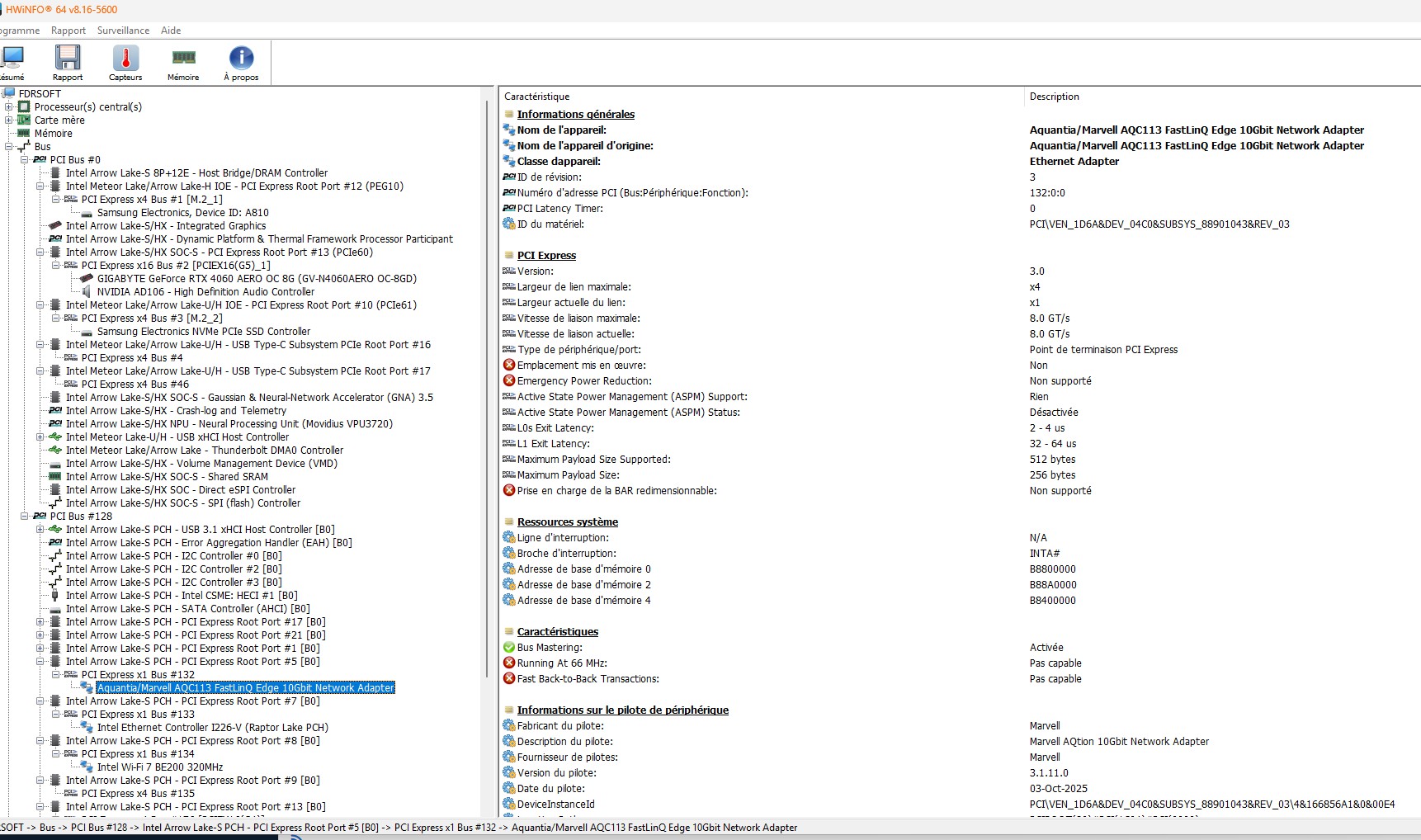

on my Z890 Proart, only X3

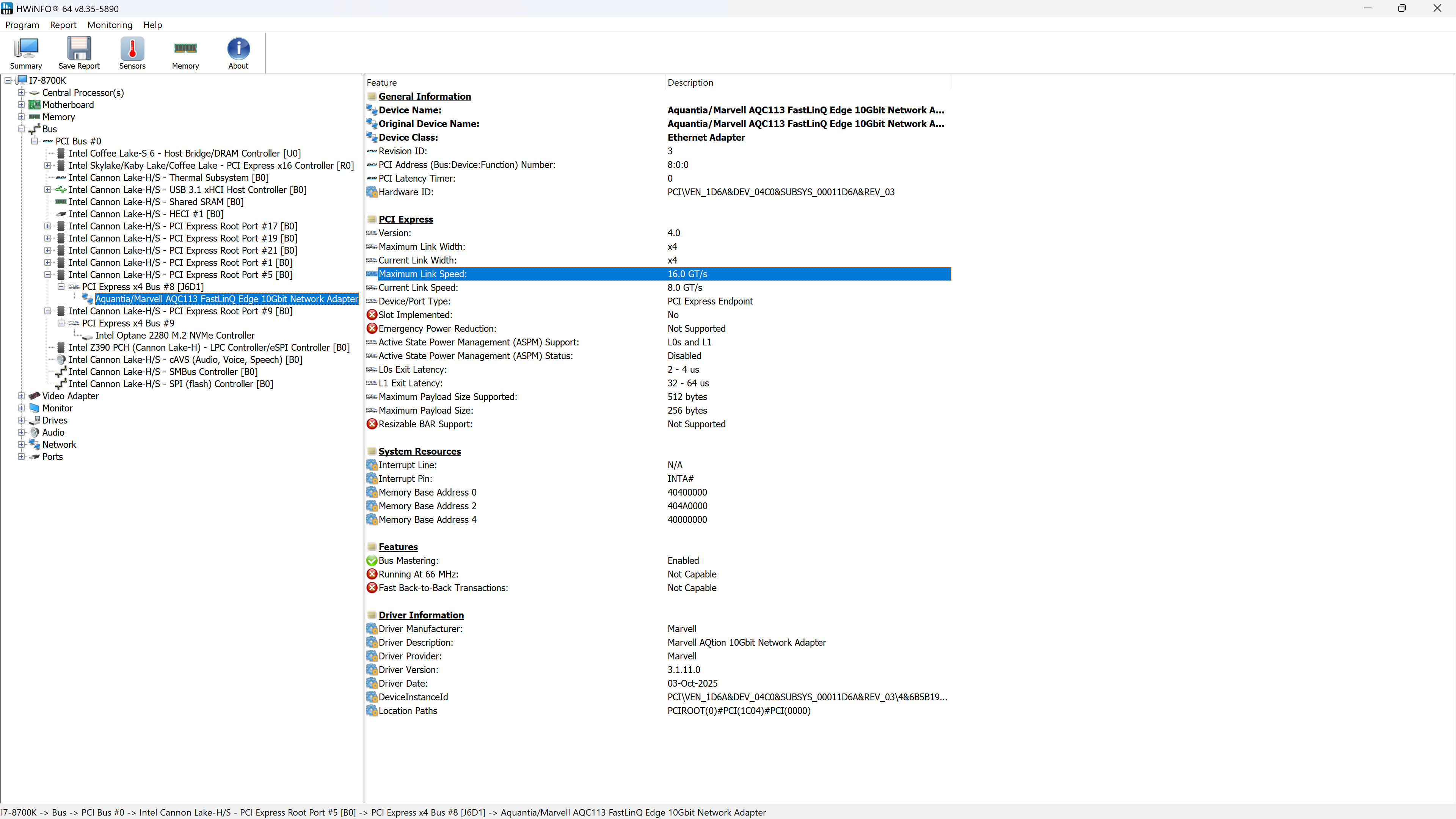

Is it a PCIE 4.0 X4 AQC113? The AQC113C's are all 3.0 i presume so as its reporting an x4 link in aida64 but i never trust aida64 for things like this tbh
here's my 4.0 card its in a Z390 atm so cant link at that speed ofc
i doubt its going to go back in a 4.0 pc again but dont want to cripple it in firmware just for the latest orom

On my Z890 Proart, I can confirm that it works on the X3. But does it make much difference on the X4?
Yes ofc your only at 3.0 x1 after overheads that means you will only get 6.7gbps max with jumbo frames not 9.91gbps for x1 you need 4.0
