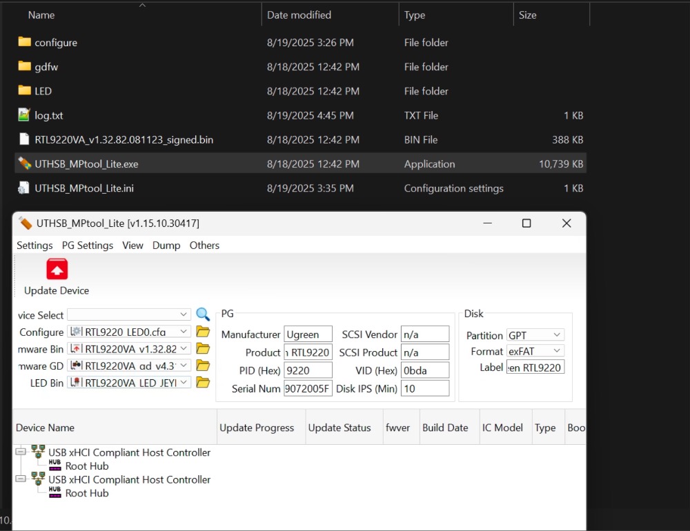

because the LED bin file is too old (from 2023), Although it has been configured the same as the original dump file, but the LED did not work as originally enclosure version; therefore we need to update LED bin file.
I sent email to Ugreen support, hope they can ship suitable firmware.

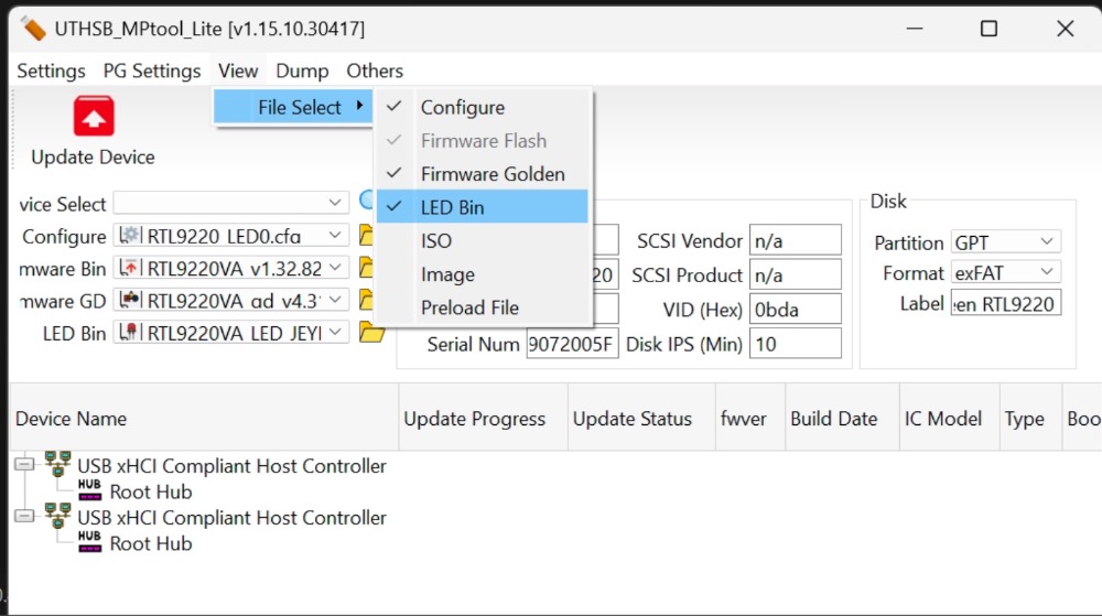

It shipped with 1.32.82 version, but too old. You can try it.
1. Download firmware version as link below
2. Select View/Led bin
3. update firmware
www.station-drivers.com/index.php/en/com...2.081123/lang,en-gb/

Thank you, I managed to make a part work and by changing the led line of the CFG file now the part flashes but not on the whole part, too bad
VID = 0xbda
PID = 0x9220
MANUFACTURE = "Realtek"
SCSI_VENDOR = "Realtek"
PRODUCT = "RTL9220"
SCSI_PRODUCT = "RTL9220"
SERIAL = "012345678918"
DISK_IPS_THRES = 1
LED = 0x3
;HW_LED_CFG = 0x0
CUSTOMIZED_LED = 42 00 02 00 00 00 00 00 00 00 00 00 00 00 00
;SUSPEND_LED_OFF = 0x0
UART_DBG_PIN = 100
PERIPH_API = 1
UART_BAUD_RATE = 57600
SUSPEND_DISK_OFF = 0x7
SCSI_WP_PIN = 0xb
