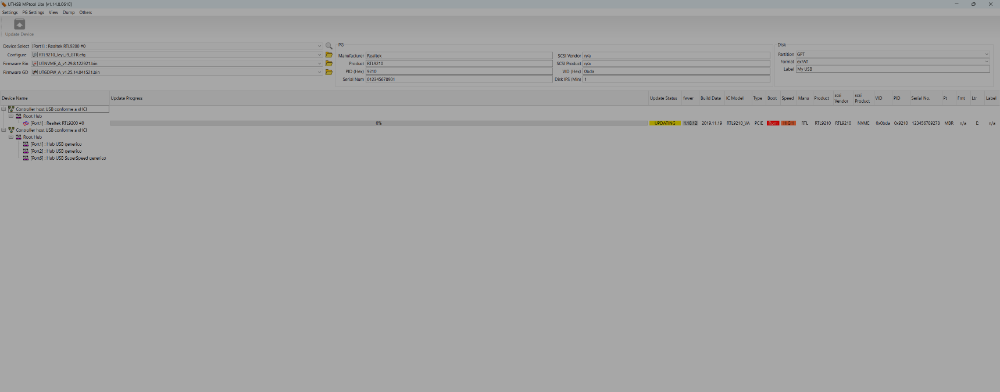

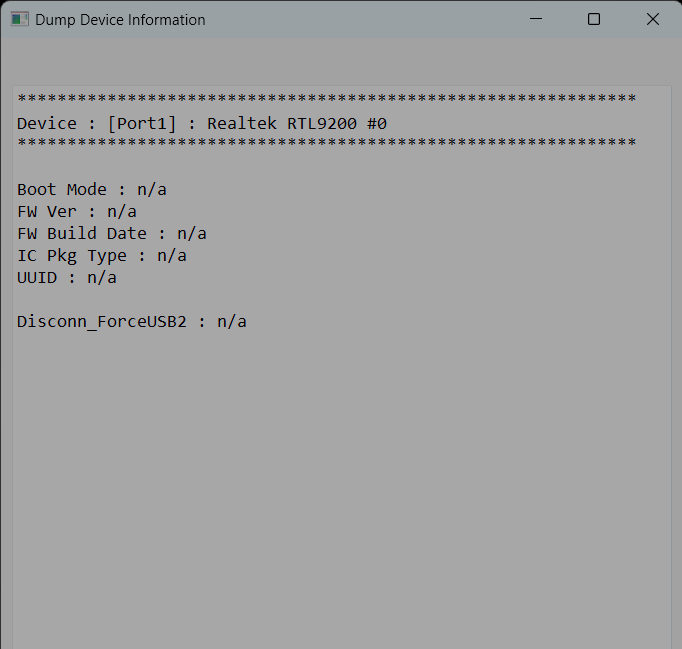

Hi everyone i'm new here. I signed up to ask for help, here is the story:
i bought a jeyi i9 with cable bay three years ago from a chinese web shop but upon arrival, it only worked for few minutes and never woke again.
Looking online for a flashing procedure, i found the shorting procedure but applying it on the wrong chip, it never worked.
Today i was updating my rtl9210 enclosure and seeing the procedure on the first page, with detailed procedure, i thought maybe i can fix that one and use it this way.
After twenty minutes of tests i was able to short correctly the pins and noticed that the drive was recognized right after 1 or 2 seconds, not 10, but most of the fw and softwares were not able to see update the firware.
The chip automatically disconnected after 25-30 seconds. In the end, using mptool version 1.15 and fw 1.29.8, golden binary and serial mode, with cfg rtl_9210_lite i was able to flash successfully (this time the bar arrived at 100% other tests stopped right at 0%.
In the end i left it connected some minutes but it disconnected after a while and never woke up again.
If i try the shorting procedure now, nothing happens.
The fw was ver A since it's a very old drive coming from version 1.18 or so, but i was not able to verify the uuid. It showed as "boot mode: rom" instead of flash.
Any idea to get it working again and fix one for all? Or maybe i just have a broken one?
Thankshttps://ibb.co/hKFnSHW

Hi, for me personally if despite the recovery the box does not react it must have a problem either with usb cord or electronics
Maybe others have ideas
