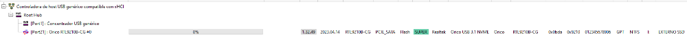

Hello everyone new member here thx all for the hard work and the info i have a unionsine carry it works well and i got it updated to last firmware no problem. got one issue cause i dint read and updated at once i dint dump my config file currently im using a oricoro one and it works well led ligths and all but i saw other people said they had unionsine carrys too. if it is not too much trouble can someone post their config dumps ?
