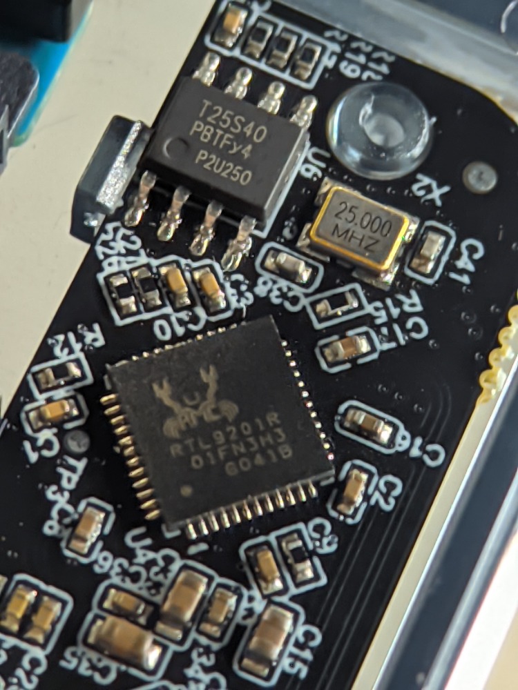

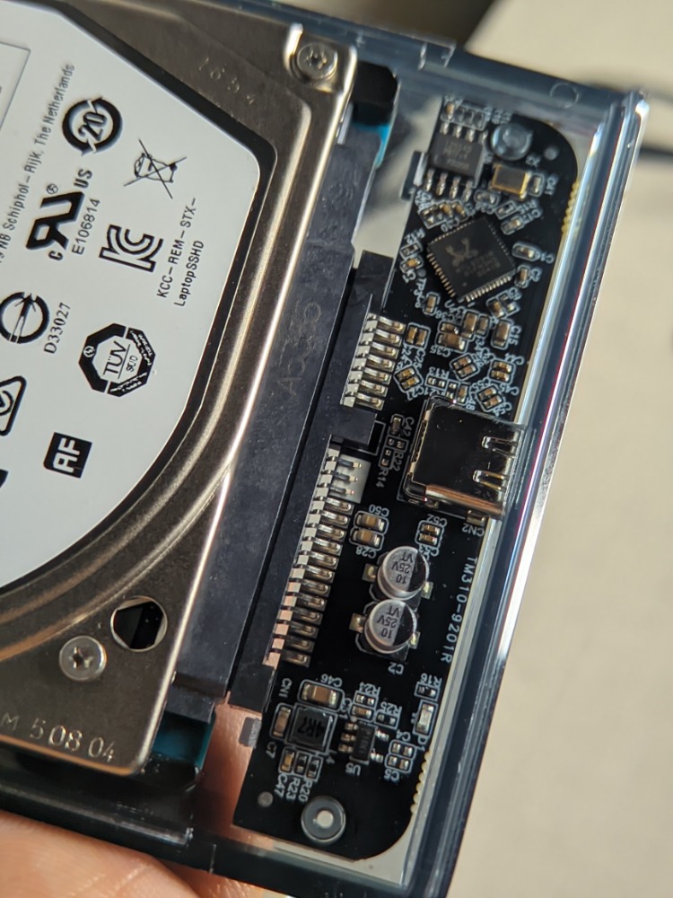

Hey everyone, how's it going?
Recently, I bought an USB C Sata Enclosure. Brand is eaget. Chipset seems to be Realtek's RTL9201R. My problem with it, is that after a while... possibly between 1 and 5 minutes, the HDD is sleeping. Changes all the Windows settings related to power saving configs and had no success on it. Googling around, I found station-drivers and saw a few posts with mptool. So I gave it a go and got a dump text for my enclosure. Can you guys help me finding out how to disable this sleep timer?
Thanks!U2PHY : n/a
U3PHY : n/a
PID : 0x9201
MANUFACTURE : "Realtek"
PRODUCT : "RTL9201"
SERIAL : "012345678999"
SCSI_PRODUCT : "n/a"
SCSI_VENDOR : "n/a"
USB_SELF_PWR : n/a
DISK_HOTPLUG : 0x03
LED : 0x03
PINMUX1 : n/a
PINMUX2 : n/a
U2_MAXPWR : n/a
U3_MAXPWR : n/a
ASPMDIS : n/a
DISK_IPS_THRES : 0x03
CUSTOMIZED_LED : 08 00 00 00 00 00 00 00 00 00 00 00 00 00 00
DIS_SHOW_EMPTY_DISK : 0x01
UART_DBG_PIN : 0x64
SUSPEND_DISK_OFF : n/a
CUSTOMIZED_FEATURE : n/a
PERIPH_API : n/a
RAID_CFG : n/aBoot Mode : Flash
FW Ver : 1.32.7
FW Build Date : 2022.11.25
IC Pkg Type : SATA
UUID:n/aDisconn_ForceUSB2 : false
