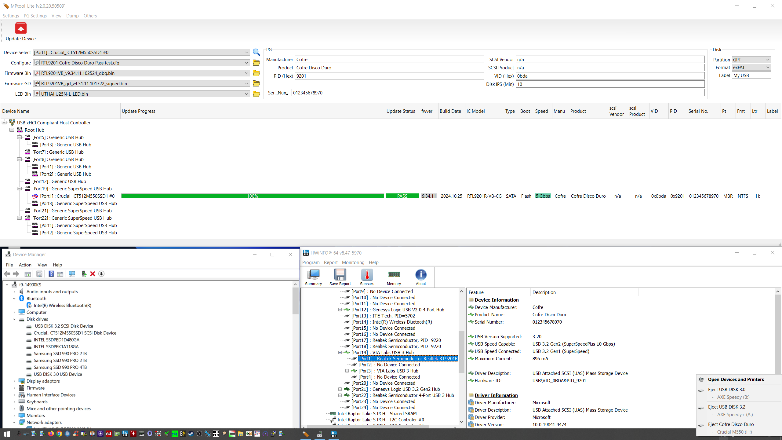

I think i know what the problem is some of my RTL9201R's have 2Mbit spi chips
this firmware is 452k so it needs 4Mbit though there's alot of FF's in the file so i may be able
to trim it down
Ok it can only trim down to 244 KB it wont flash to a 2Mbit SPI
I know a few of my pcb's have 8Mbit SPI's some 4Mbit some 2Mbit
I have checked my enclosures
Cofre Disco Duro x 5 4Mbit SPI 1.33.88 Firmware Flashable 4Mbit SPI (needs correct LCD.bin will test flashing one at some point)
UTHAI/ShuoLe U25N-L x 2 4Mbit SPI 1.34.29 Firmware Flashable 4Mbit SPI (needs correct LCD.bin)
UTHAI Q5 x 4 2Mbit SPI 1.32.7 Firmware
UTHAI Q6 x 6 2Mbit SPI 1.32.7 Firmware
UTHAI Q7 x 7 2Mbit SPI 1.32.7 Firmware
to trim it down

I have just noticed i can extract the led.bin from spi dumps
its 0000 to 3FF0 its the first thing flashed to the SPI
I will do the Cofre Disco Duro and UTHAI/ShuoLe U25N-L led.bin's in a few mins
I have tested the extracted LED.bin's
Both work fine they also both work fine on the Cofre Disco Duro
it doesnt look quite as good on the Cofre Disco Duro though as it only has 2 RGB Led's
instead of 5 on the UTHAI U25N-L
Cofre Disco Duro LED is a breathing effect CUSTOMIZED_LED = 41 00
UTHAI U25N-L LED is a wave effect CUSTOMIZED_LED = 41 02
