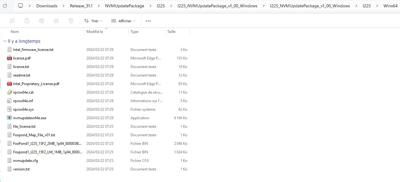

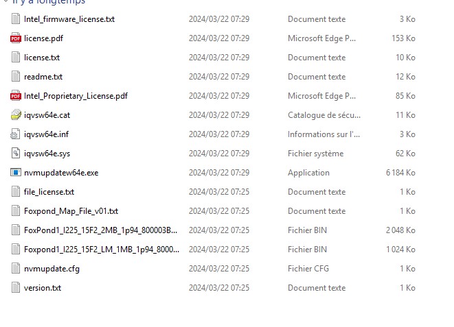

Hi, download the latest Intel Network Pack; the necessary files are in the NVM directory.
Intel Nework 31.1
www.station-drivers.com/index.php/en/com...ion-31.1/lang,en-gb/
Alternatively, run the command `nvmupdatew64e.exe -i -l inventory.txt`.
To update, simply change the firmware of the NVM directory in the Intel network pack and replace it with the one you want.
