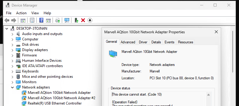

Re: Marvell/Aquantia AQC113, AQC113C, AQC113CS (10Gbps) Firmware Version 1.5.48
3 meses 3 semanas atrás - 3 meses 3 semanas atrás
How can I flash this onto dual 10G? Is this the wrong firmware?
I have the "This device cannot start. (Code 10)" Issue.
Device is a "UGREEN NASync DXP6800 Pro".
It might be bricked?
.\kickstart2.exe -v
Connected to device '0000-58:00.0'
Register 0x00003048: 0xffffffff : 11111111 11111111 11111111 11111111
Register 0x00003040: 0x00000001 written
Register 0x00003040: 0xffffffff : 11111111 11111111 11111111 11111111
Ultima edição : 3 meses 3 semanas atrás por chilli8733.

@chilli8733
Yup. I bricked my QNAP Dual 10G card as this firmware is all pretentious about knowing how to update dual 10G cards but borks them totally.
To all reading this: Do not update your Dual 10G cards with this or previous firmware. The updater is not designed to update firmware in such scenario. If you have firmware dump of previous firmware and know how to reflash it using the JTAG debugging tools then be my guest !
You have been warned.
