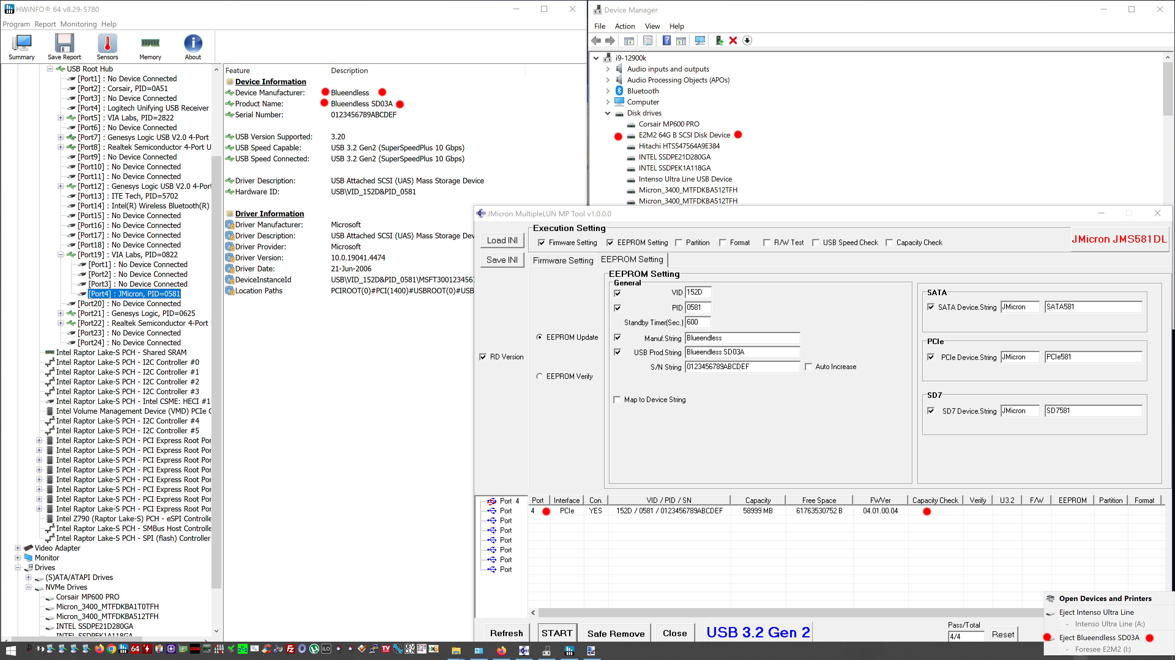

open
JMicron MP Tool v1_0_0_0.exe
tick RD Version
password = jmicron
goto EEPROM Settings tab
it should be on EEPROM Update
dont untick or tick anything
Manuf. String = Blueendless (Change to JMicron if desired)
USB Prod. String = Blueendless SD03A (Change to JMicron JMS581 if desired)
Click Start when done

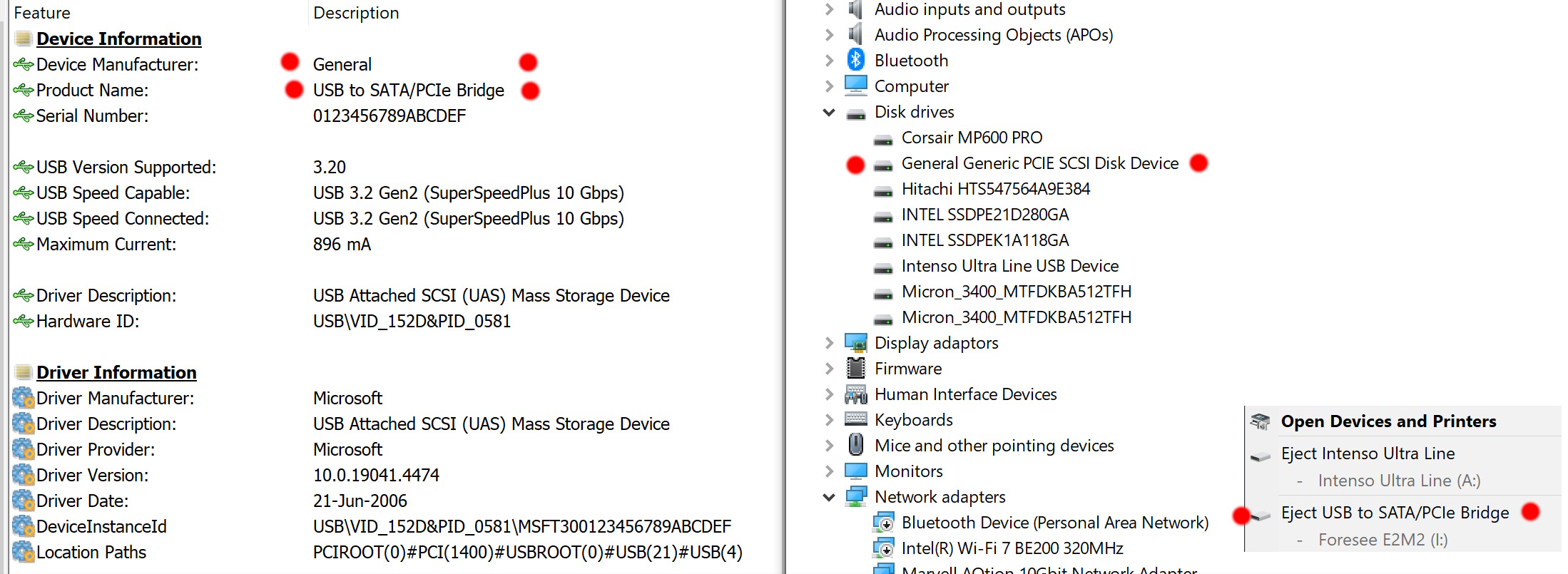

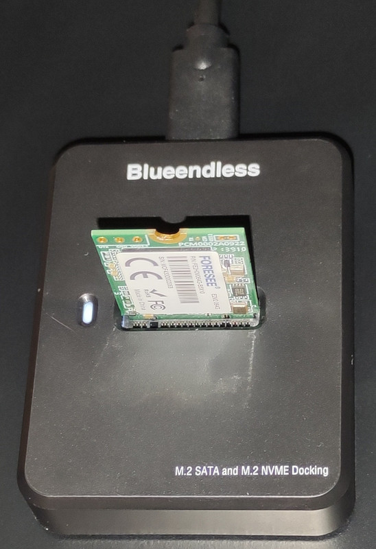

Before
After

there are photo's of the PCB JMS581DL SPI etc in the zip

Flashing Instructions
open
tick RD Version
password = jmicron

Before
After
