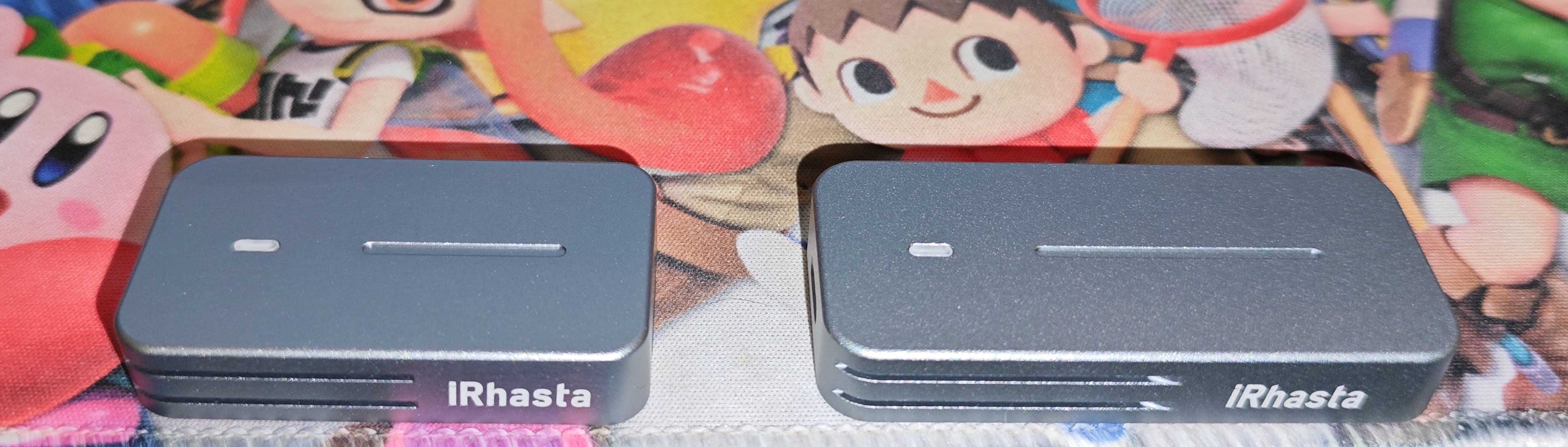

Its a RTL9220 that i have on order the PCB is the same layout and size as my iRhasta 2230 and 2242 enclosures
i have a mix of RTL9210B and JMS583 PCB's in them
anyway i have got this to put a Sata drive in will be replacing this enclosures pcb with a RTL9210B for that
then turning one of my iRhasta 2230's into a 20Gbps RTL9220
Its a 2280 Variant of these enclosures i have but with a RTL9220-VB-CG they make it in black or gunmetal
so ordered a black one for a change (with the rubber bumper)
www.aliexpress.com/item/1005011839178877.html
