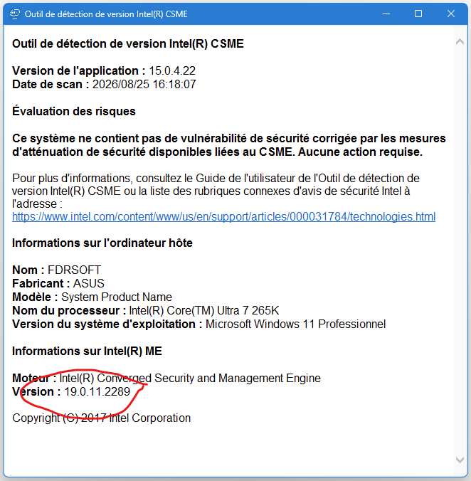

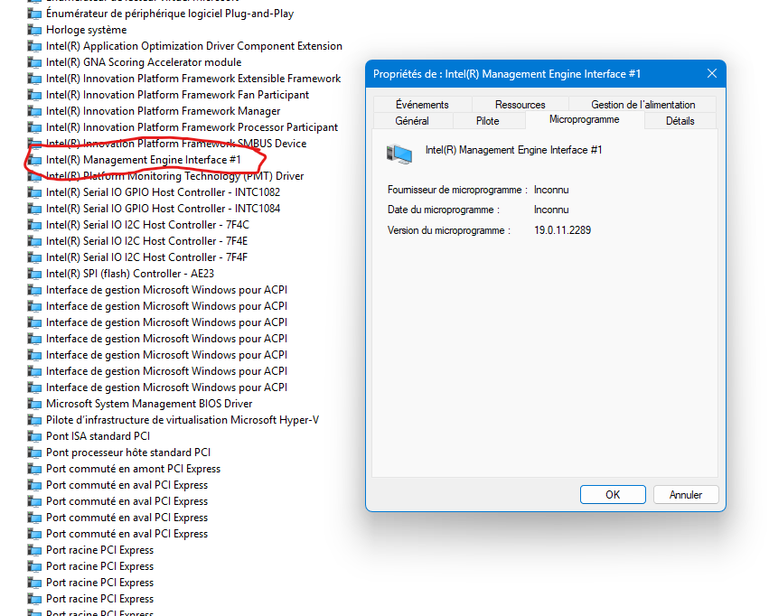

Hi, thanks for the info. Yes, there are two versions—14.x and 14.5—so it depends on the specific version; that’s why you should always check the series.
Intel Comet Lake-V (14.5.xxxx)
Intel Comet Lake (14.x.xxxx)
Always check via Device Manager or the Intel utility below.
