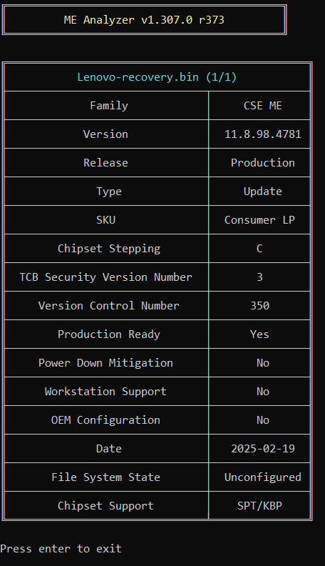

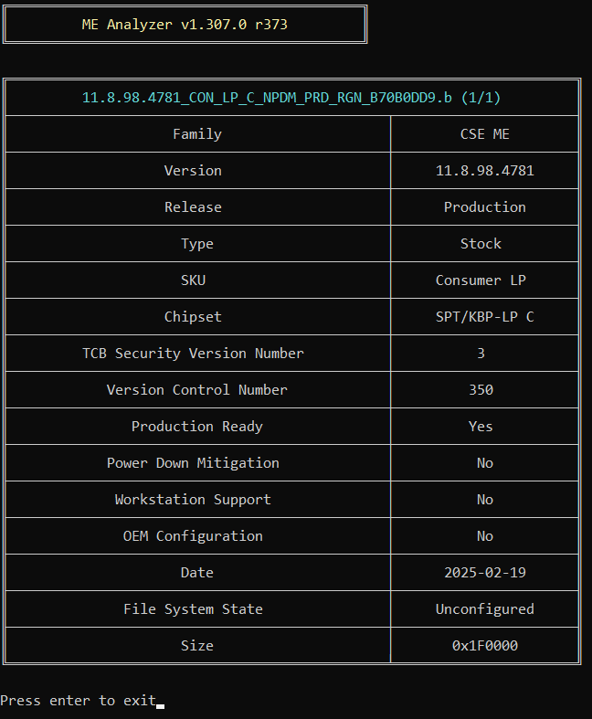

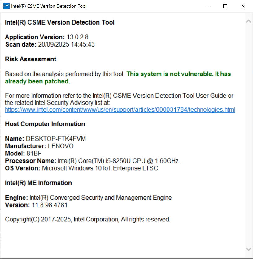

Latest firmware ⬇️
11.8.98.4781
19.FEB.2025
SKU: Consumer LP Chipset: SPT/KBP-LP C
11.8.98.4781_CON_LP_C_NPDM_PRD_RGN_B70B0DD9.bin
⬇️ winraid.level1techs 20.SEP.2025
⬇️ mega.nz 21.SEP.2025
🔗 MEAnalyzer r373 21.SEP.2025
🔗 Intel® CSMEVDT 13.0.2.0008 31.JUL.2025

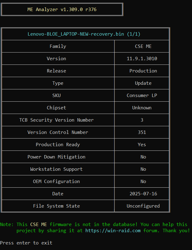

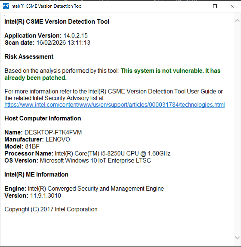

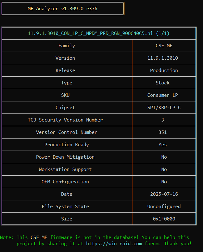

11.9.1.3010 16.JUL.2025
11.9.1.3010_CON_LP_C_NPDM_PRD_RGN_900C40C5.bin
⬇️ mega.nz 07.FEB.2026
🔗 MEAnalyzer r376 22.DEC.2025
🔗 Intel® CSMEVDT 14.0.2.0015 31.JUL.2025

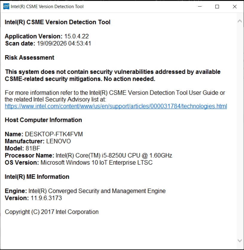

Intel® Converged Security and Management Engine Version Detection Tool (Intel® CSMEVDT) 15.04.22

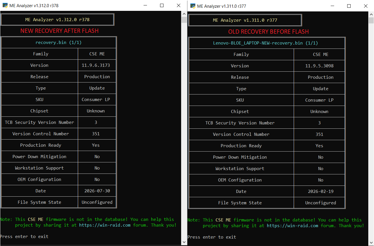

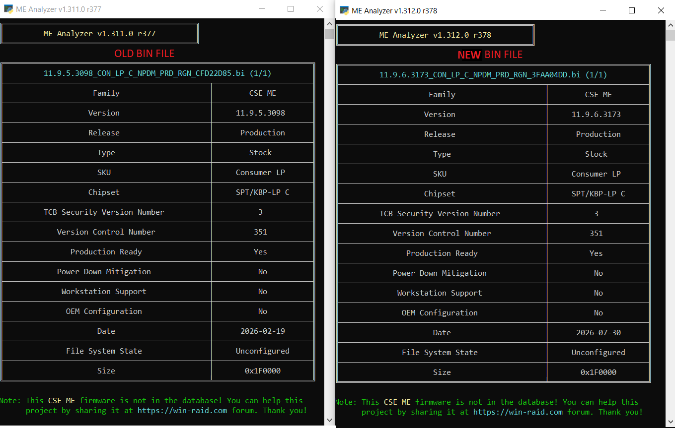

Latest MEAnalyzer (MEA v1.312.0 r378)
winraid.level1techs.com Original post
winraid.level1techs.com 11.9.6.3173_CON_LP_C_NPDM_PRD_RGN_3FAA04DD.rar
station-drivers.com Intel Management Engine (ME/AMT) Firmware Version 11.9.6.3173 (LP)(1.5Mo)
Date & Version: 2026/07/30, 11.9.6.3173 (1.5Mo)
Release: Production
SKU: Consumer LP 1.5Mo
Region: Stock
For: Intel 100/200/300-series LP chipsets
Includes: Firmware 1.5 & Utilities
Firmware Backup Instructions
1. Open Command Prompt / Terminal as Administrator and navigate to the folder containing FWUpdLcl64.exe.
2. Save the current firmware by running:
Firmware Update Instructions
1.Make sure the new firmware file is in the same folder as FWUpdLcl64.exe.
2. Again, open Command Prompt / Terminal as Administrator in that folder and run:
4. Reboot
Important: Make sure you have a valid backup (recovery.bin) before proceeding with the firmware flash.
Release: Production
Region: Stock
3. This will save a backup of the current firmware as recovery.bin.FWUpdLcl64 -save recovery.bin
3. This will flash the new firmware to the device. Do not interrupt the process or power off the system while the firmware is being updated.FWUpdLcl64 -F 11.9.6.3173_CON_LP_C_NPDM_PRD_RGN_3FAA04DD.bin
4. Reboot
