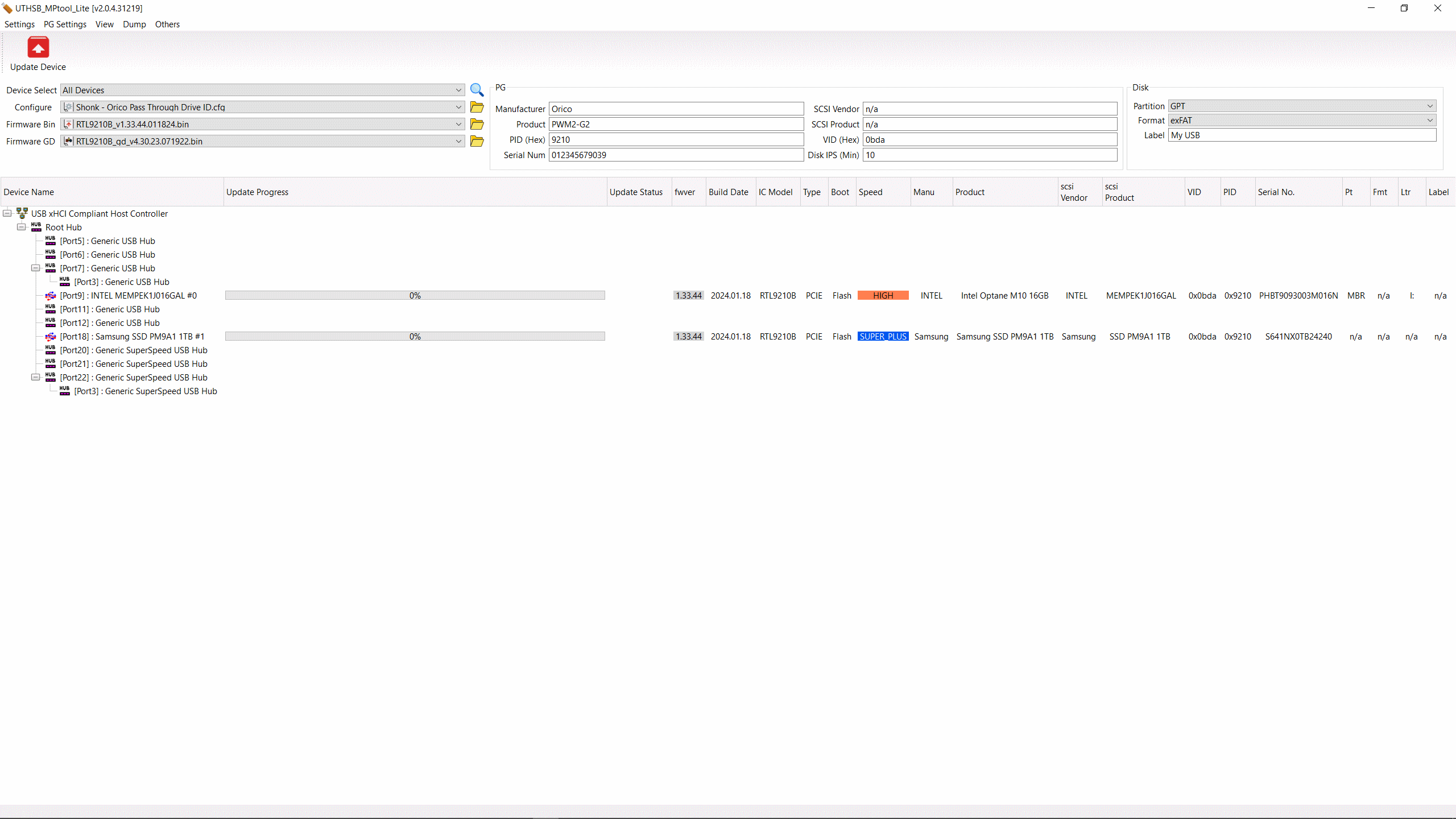

I have 9 x PWM2-G2 one of them sometimes connects at USB 2.0 (not very often though)
its down to the cable or the USB C connector
Here's the correct config for the PWM2-G2
I use Shonk - Orico Pass Through Drive ID.cfg
But there is also Shonk - Orico Stock.cfg in there if you want it to id as Realtek RTL9210B-CG
mega.nz/file/MuwmRIqS#GesyqNxqHxZMMsZSUo...Y2aumRkFI4UcrUlsnGXI
If after flashing this it is still USB 2.0 you can try spraying some 100% isopropanol in the USB C port of the enclosure and cleaning in there with a toothbrush
I had to do that once on a JMS583 to fix it
if you dont have any isopropanol you could use Windowlene and a toothbrush but you would have to leave it much longer (i would leave it for an hour or so on a warm radiator with the ssd removed) to dry out
make sure it has fully evaporated before connecting it back up
most enclosures you have to have a drive fitted for over USB 2.0 btw RTL9210 you for sure have to
Samsung PM9A1 has a drive in it
Intel Optane M10 i removed the drive to show you
