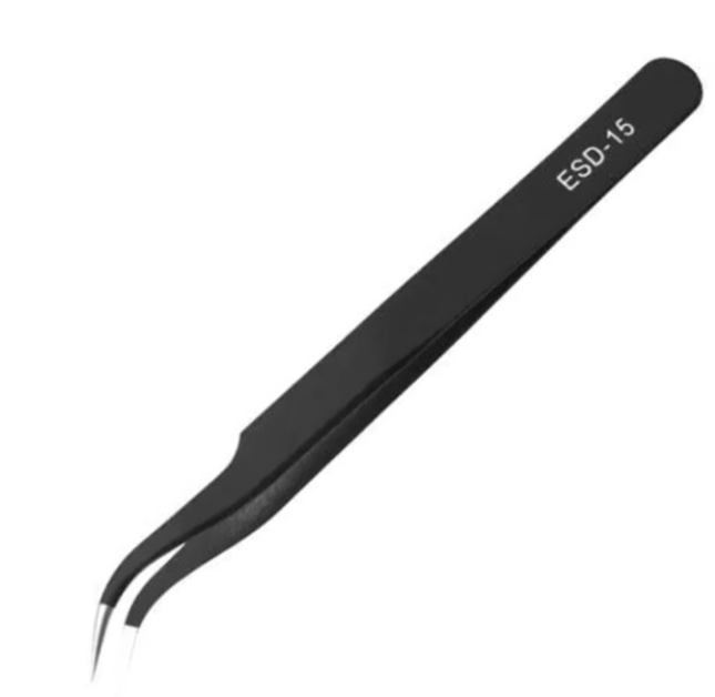

I broke the NVME connector trying to pry out the PCB (and broke tweezers), so it's over. I will still try to get it out to see if there's a chip at the bottom.

It happens that the firmware doesn't go well, but luckily there is this solution. As Shonk said, be careful not to touch other contacts; I do it with fine-tipped tweezers.
