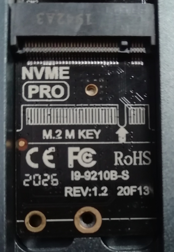

i got an enclosure JEYI i9GTR-2280 bought on Aliexpress with a RTL9210 chip and a very old firmware v1.21.17.
The goal is to flash v1.29.12.
Windows see the enclosure as RTL9210 but on the pcb i can read 9210B.
This is my dump file, can you please edit it?

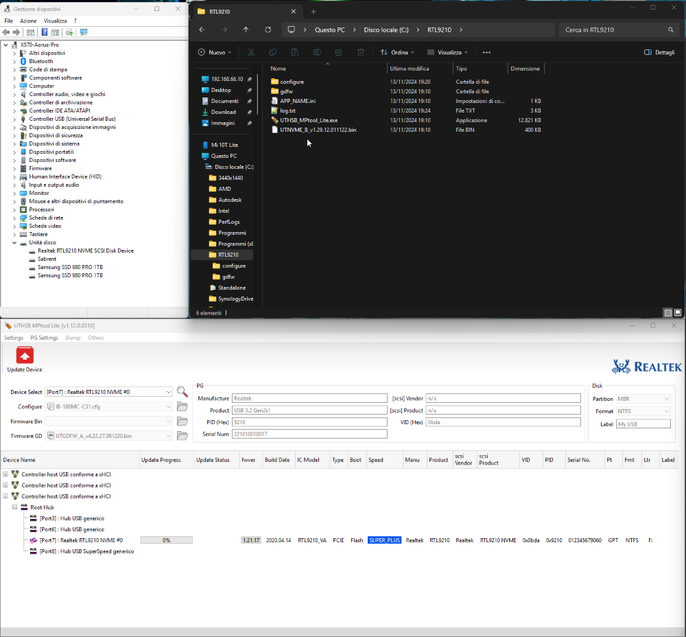

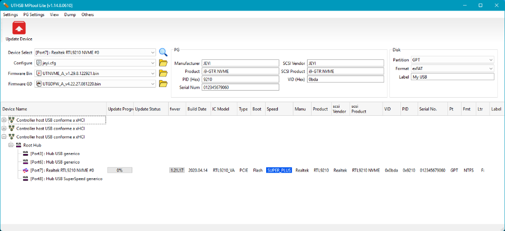

There was already in the configure folder a file named jeyi.cfg, i edit it just with my serial, than i used UTHSB MPtool Lite V1.14.8.0610 present in the main folder and full unlocked as you can see in the image attached.
From my point everything was right, i toke off the ssd, i switched off even the windows antivirus.
Few second after i started the update, i got an alert from the os (Win 11) of unknown device and few second later the flash procedure got error
I bricked my enclosure
