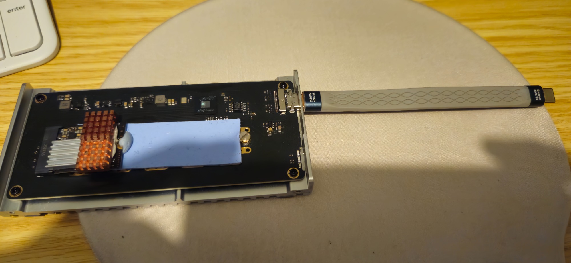

I found the 20 or 30cm cable that came with my enclosure
that is supposed to work at 40gbps didnt work on my 11950H
gen2x2 instead of gen3x2
ended up using 10cm flat cables it operates at 40gbps now (gen3x2)
so no havnt tried any longer ones

This could also be due to the disk not being recognized; it happens, hence the importance of updating the firmware regularly. As Shonk rightly said, I have a 10cm cable and it works perfectly.
