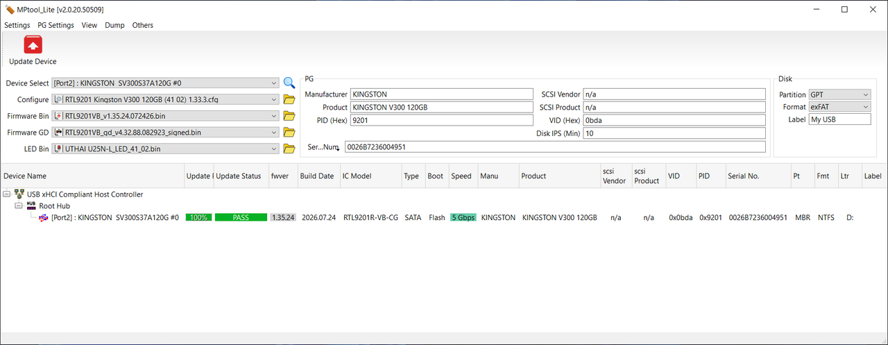

Where did you get this admin
Dont use the updater exe with RTL9210R btw it adds some weird flags to the config
one of which is force 10Gbps which is disabled on RTL9201R at the factory in the downbin process
so you only get USB 2.0 Connects after the update
using it with the Windows Gui updater and your old config is fine
With the New Command line updater
With Windows Gui Updater and correct config for my Device
C:\Realtek_RTL9201VB_1.35.24>rtk_fwupdate_signed
[INFO] Loaded config: C:\Realtek_RTL9201VB_1.35.24\config.ini
[INFO] rtk_fwupdate v1.0.0.60820 - Firmware Update Tool
[INFO] Bin: C:\Realtek_RTL9201VB_1.35.24\RTL9201VB_v1.35.24.072426.bin
[INFO] Rescue: C:\Realtek_RTL9201VB_1.35.24\RTL9201VB_gd_v4.32.88.082923_signed.bin
[INFO] Config: C:\Realtek_RTL9201VB_1.35.24\RTL9201.cfg
[INFO] LED: (none)
[INFO] Running as administrator
[INFO] Expected FW version: 1.35.24, build date: 072426
[INFO] Scanning for devices...
[INFO] Found device: \\.\PhysicalDrive1
[INFO] Current FW version: 1.34.29, build date: 011325 (yyyymmdd: 20250113)
[INFO] FW version differs: expected 1.35.24, current 1.34.29
[INFO] Proceeding with firmware update...
[INFO] Firmware update completed successfully.
[INFO] Waiting for device to reconnect...
[INFO] Device reconnected: \\.\PhysicalDrive1
[INFO] New FW version: 1.35.24, build date: 20260724
