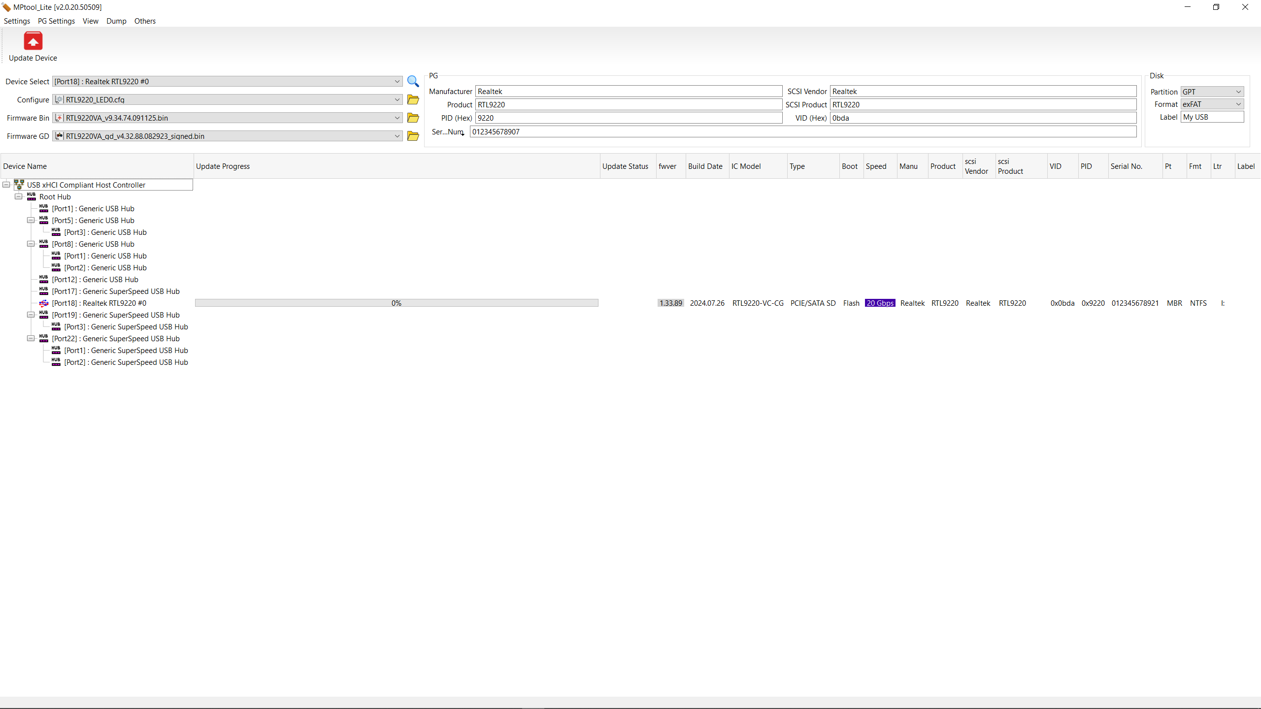

2 månader 1 vecka sedan
My RTL9220-VC-CG Turned up it came with 1.33.89 firmware
if i flash RTL9220_LED0.cfg it updates fine but its not setup for my device ofc
I made a custom config which results in a failed flash and a brick
I have found the problem setting CUSTOMIZED_LED = 33 00 00 00 00 00 00 00 00 00 00 00 00 00 00 causes the failed flash
CUSTOMIZED_LED = 00 00 00 00 00 00 00 00 00 00 00 00 00 00 00 flashes fine
am i missing something to be able to set CUSTOMIZED_LED = 33 00 00 00 00 00 00 00 00 00 00 00 00 00 00
an LED bin maybe?
the LED isnt working btw with CUSTOMIZED_LED = 00 00 00 00 00 00 00 00 00 00 00 00 00 00 00

Device : [Port3] : Realtek RTL9220 #0
U2PHY : n/a
U3PHY : n/a
PID : 0x9220
MANUFACTURE : "Realtek"
PRODUCT : "RTL9220"
SERIAL : "012345678921"
SCSI_PRODUCT : "RTL9220 "
SCSI_VENDOR : "Realtek "
USB_SELF_PWR : n/a
DISK_HOTPLUG : n/a
LED : 0x01
PINMUX1 : n/a
PINMUX2 : n/a
U2_MAXPWR : n/a
U3_MAXPWR : n/a
ASPMDIS : n/a
DISK_IPS_THRES : 0x0a
CUSTOMIZED_LED : 33 00 00 00 00 00 00 00 00 00 00 00 00 00 00
SUSPEND_LED_OFF : 0x00
FORCE_PCIE_QUIRK : 0x00040000
DIS_SHOW_EMPTY_DISK : n/a
UART_DBG_PIN : 0x64
HW_LED_CFG : 0x00000000
SUSPEND_DISK_OFF : 0x07
CUSTOMIZED_FEATURE : n/a
PERIPH_API : n/a
RAID_CFG : n/a
RW_MODE : n/a
FORCE_SATA_QUIRK : n/a
FW Ver : 1.33.89
FW Build Date : 2024.07.26
IC Pkg Type : PCIE/SATA SD
Disconn_ForceUSB2 : false
