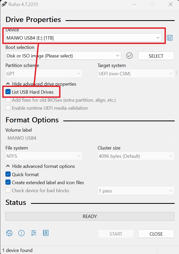

Hello, I have ShuoLe ASM2464 NVMe enclosure from Aliexpress. I inserted Crucial P3 2TB Plus into it. Works damn good. But if I connect it to USB 4 port of my Asus X870E ProArt motherboard, Rufus cannot detect the external drive. It only gets detected when connected to USB 3.2 20G or 10G ports. I checked the USB drives option in Rufus.
Secondly, when I try to boot my drive with Ventoy installed and Strelec Boot PE iso, it boots into it but fails to mount the drive containing recovery apps when plugged into USB 4 port. This issue does not happen on USB 3.2 20G or 10G ports.
Tried upgrading as well as downgrading ASM2464 frimware. I also tried downgrading BIOS, changing cables. But this is USB4 port problem.
Any solution?
