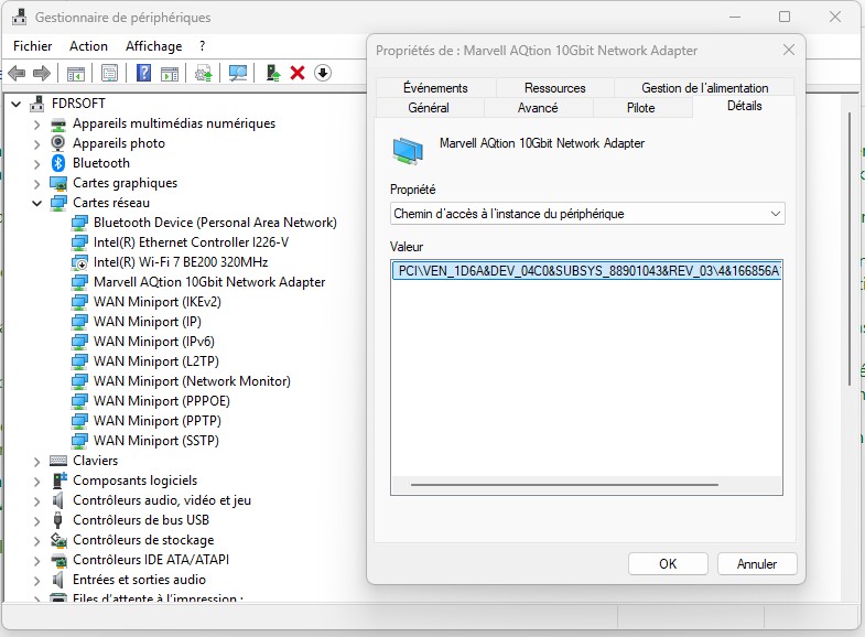

The firmware works reliably with the AQC-113C, AQC-113CS, AQC-113 chipset with an ID code starting with: VID=0x1D6A. I don't know if it works with other chipsets using the AQC-113 with a different ID.
VID=0x1D6A, DID=0x04C0,
VID=0x1D6A, DID=0x14C0
VID=0x1D6A, DID=0x94C0,

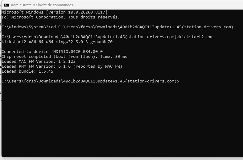

You can find out your chipset by opening an Msdos (CMD) window and typing "kickstart2.exe" from the firmware directory.
