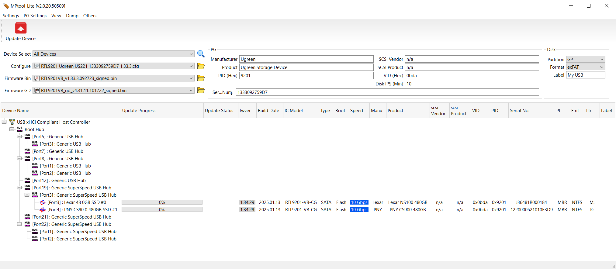

I had 3 Ugreen US221 Enclosures arrive today i have 5 already they are all ASMedia ASM235CM 10Gbps Sata Enclosures
anyway the three that arrived today one was ASMedia ASM235CM the other two where RTL9201-VB-CG and are 10Gbps
so the RTL9201R is the downbin locked at 5Gbps I updated them to 1.34.29 fine from 1.33.3 that Ugreen had used
All the latest firmware's i have for all of my devices are here
github.com/Shonk/RTL92XX
here's the cfg for the Ugreen US221 RTL9201 Variant
Here's them updated to 1.34.29

Where did you get this admin
Dont use the updater exe with RTL9210R btw it adds some weird flags to the config
one of which is force 10Gbps which is disabled on RTL9201R at the factory in the downbin process
so you only get USB 2.0 Connects after the update
using it with the Windows Gui updater and your old config is fine
With the New Command line updater
With Windows Gui Updater and correct config for my Device
