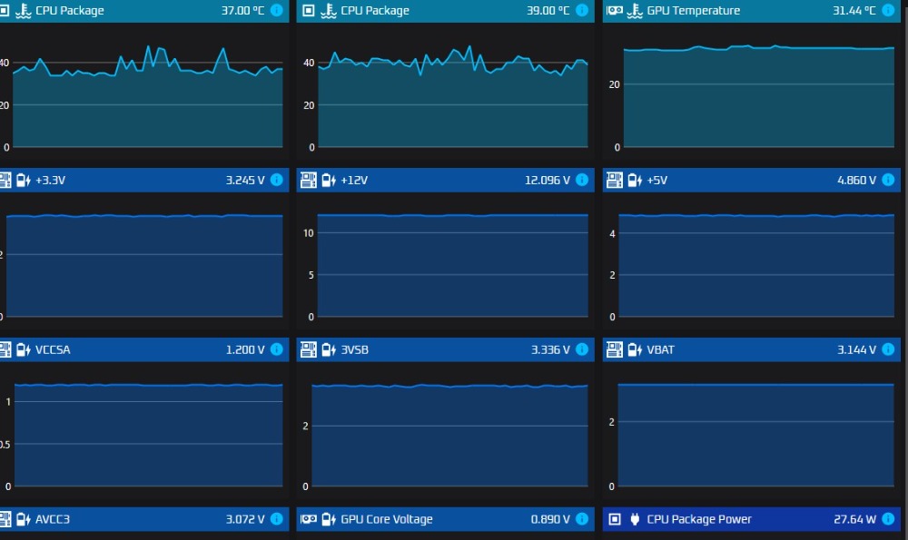

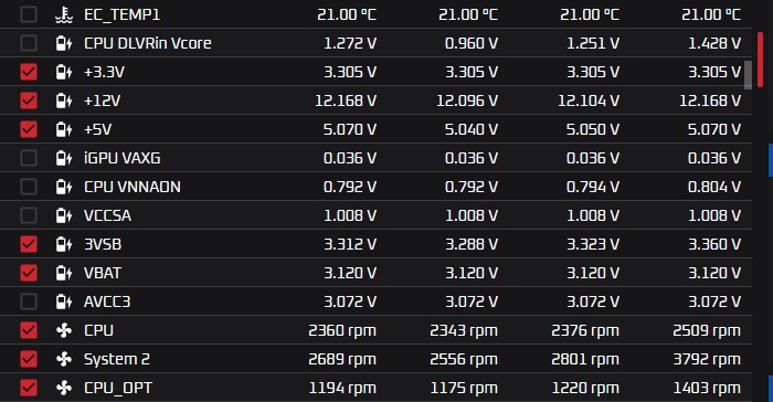

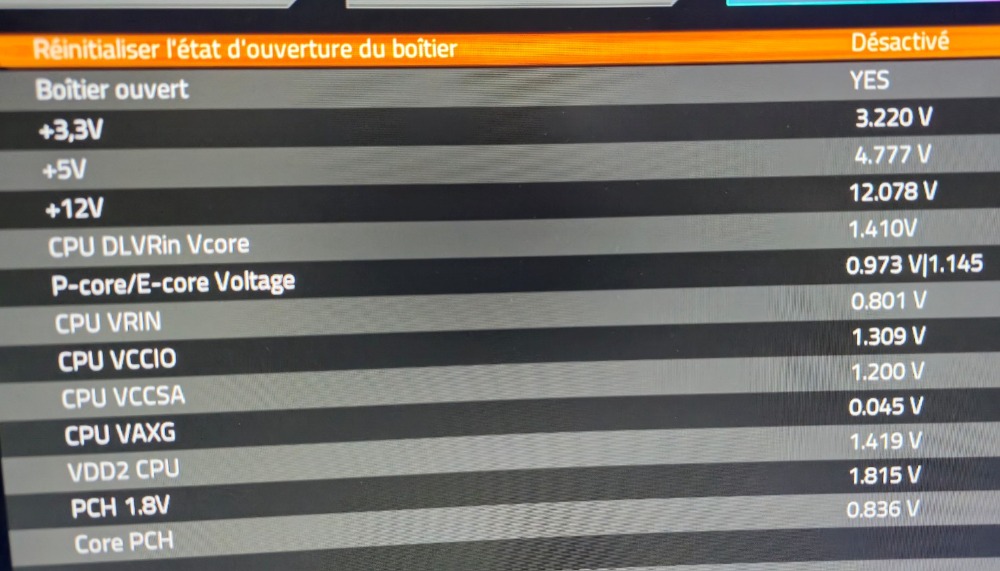

Hi everyone,
I'm having a problem with my 5V and 3.3V & VBAT voltages. Are they correct? Knowing that the values are +5 or -5%
because when surfing the web, there is little information on minimum and maximum voltages
I'm going to test with my multimeter to check if the voltages are real or not but personally I find it too accurate?

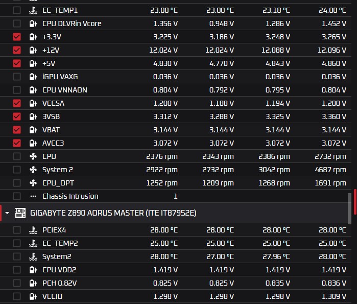

That +5-5 is not really a scale to all users systems and hw/psu models on the market. You will se all kind of different values around...
Plus the EC (ITE and others), the monitor app readings, the connected hardware etc... has a lot to say here.
VBAT is out of this because it will decrease with time... as long as it keeps above 1,8-2.0v its still capable.
Readings can be made with PSU on (Green/Black shorted, 3/4pin) of course all connectors of board, using a decent voltimeter.
My POV only, regards.

Thank you, I found the problem, it comes from the 24-pin sheathed extension cable on the motherboard which causes the voltage to drop. By directly connecting the 24-pin power supply provided by the Asus Strix power supply, everything is back in order.
