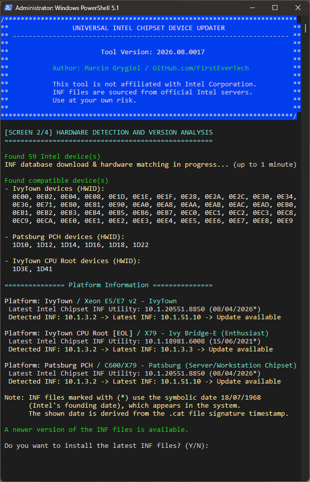

The device detection step (Get-IntelChipsetHWIDs) used to pre-filter every candidate Intel device by checking whether its FriendlyName contained one of a handful of keywords: "Chipset", "LPC", "PCI Express Root Port", "PCI-to-PCI bridge", "Motherboard Resources". Any live, fully functioning Intel System-class device whose FriendlyName didn't happen to contain one of those words was silently dropped — before it was ever even checked against the HWID database.
This surfaced through a user report (thanks again to rvail for the detailed logs): Driver Genius Free Edition flagged three Intel System devices as outdated on a Z270 desktop — 1901 (PCIe Controller x16), 191F (Host Bridge/DRAM Registers), and 1911 (Gaussian Mixture Model) — while my updater reported the system as fully up to date. A full, unfiltered PnP device dump confirmed all three were live and functioning (Status: OK) — the updater's own name-based filter was the reason they never showed up, nothing else.

- Tested on a triple-platform X79 system (IvyTown / Patsburg PCH / IvyTown CPU Root): detected device count went from 12 → 59, all correctly matched to the same three known platforms

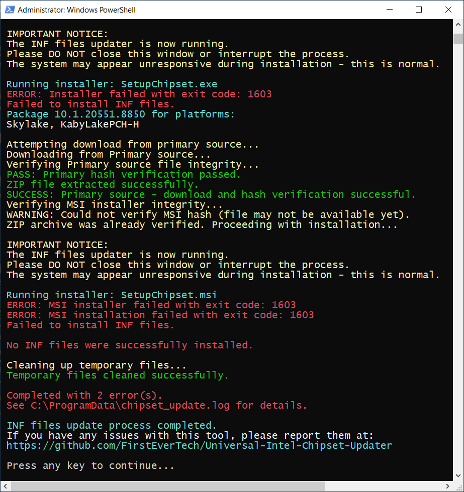

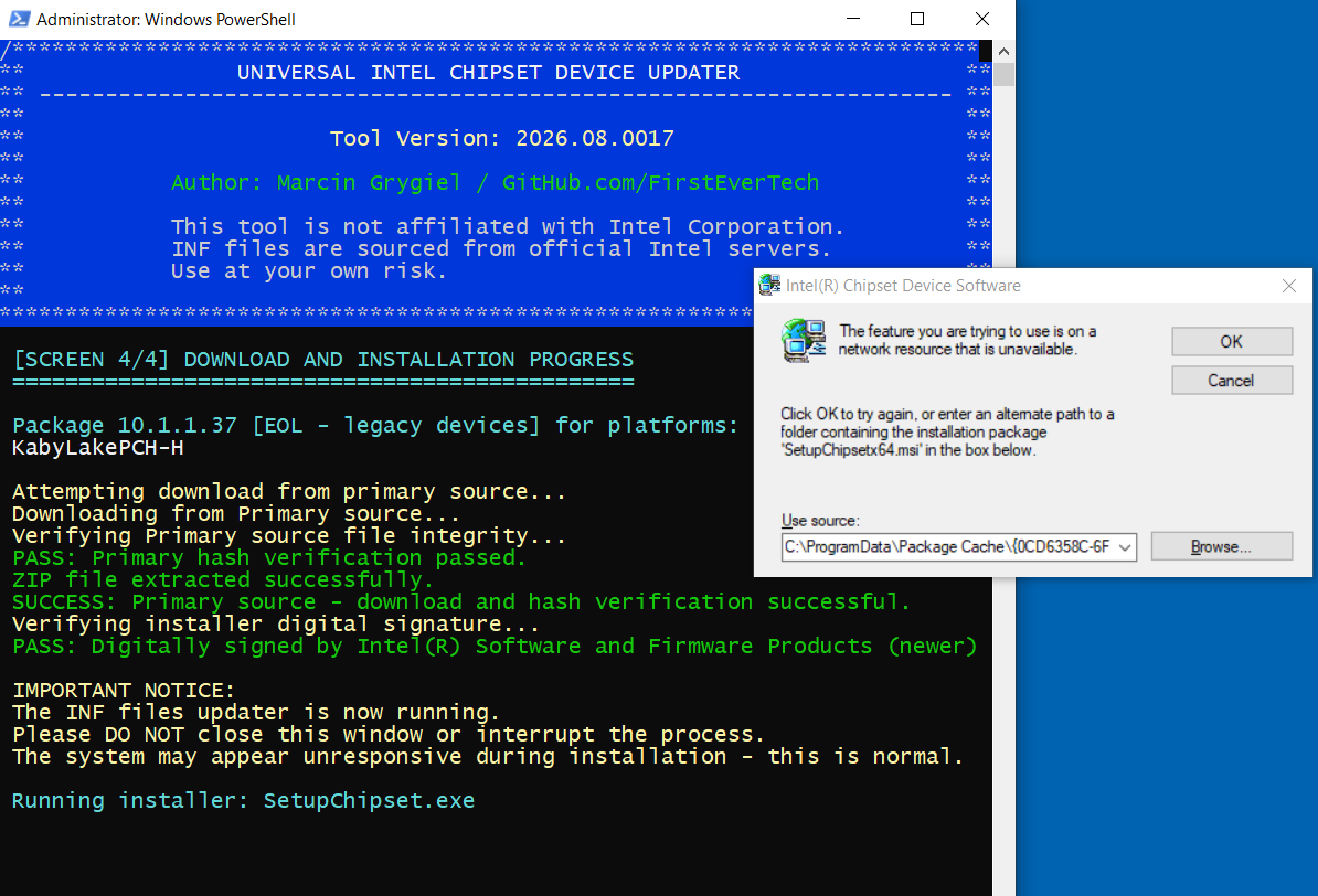

An error was discovered running your Intel Chipset Driver updater utility.
This appeared when running on the Z270 chipset motherboard, where it appears to be looking for a 64-bit installer, but your program is only finding a 32-bit version (?)
See attached screen shots:

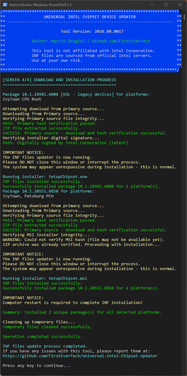

I see the problem involves some HWID EOL issue that requires downloading and installing an older installer.
I even ran a simulation that will detect x79 EOL devices for my platform.
So, just like yours, there will be HWIDs that require a new MSI installer and an old EXE installer for EOL devices.
As you can see, the installer successfully installed the EOL INF using the old EXE installer, and then used the new MSI installer to simulate updating the remaining INF. The 10.1.20551.8850 installer did indeed install, but it didn't have any INF files for my platform, so it didn't make any changes.
Most importantly, no error occurred!

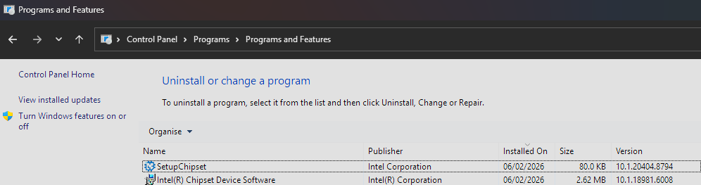

I'm starting to suspect that you simply have a corrupted previous Intel Chipset Software Device installer installed on your computer.
Try uninstalling "Intel Chipset Device Software" and "SetupChipset" in Program and Features and run my Updater again.
The log from you will still be helpful...

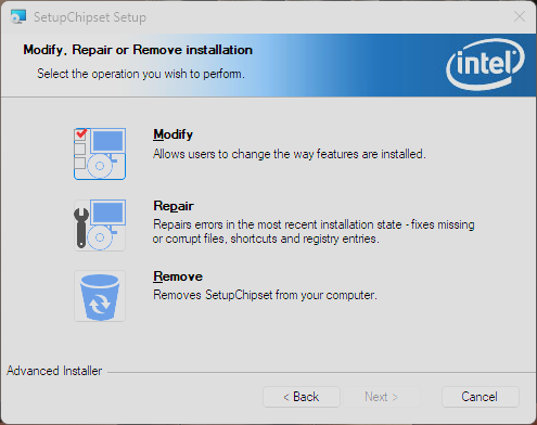

While testing all dependencies, I discovered a bug in the new EXE installer from Intel (108 MB). No matter how many times you install it, it will never detect that it is already installed, so you'll never see the "Modify, Repair, or Remove" maintenance dialog. Instead, you'll always be presented with the license agreement and the option to install the product. Do they even have a software QC department?
However, if you extract the MSI installer from the package and install it directly, you'll see the "Modify, Repair, or Remove" dialog the next time you run the MSI installer.
Upon reflection, Intel blocked MSI so that it cannot be run individually - so you will never actually see this window.
- You have the latest INF files installed for all HWIDs (from installer 10.1.20551.8850)
- The updater detects an update for a specific EOL HWID—an INF file that is missing from the latest Intel installer (MSI).
- It is clearly visible (Screen 4) that the updater is trying to download and install the missing EOL INF from the 10.1.1.37 installer.
The error occurs during the attempt to install SetupChipsetx64.msi—meaning it is trying to use the new installer.
I need to check the code again... everything seems to be okay.
- Go to %ProgramData%\ and delete the file chipset_update.log
- Run my updater again with the -debug flag added (e.g. .\universal-intel-chipset-device-updater.ps1 -debug) — you should get the same error again, but this way the log will capture a lot more detail
- Send me the new %ProgramData%\chipset_update.log file so I can analyze it.
